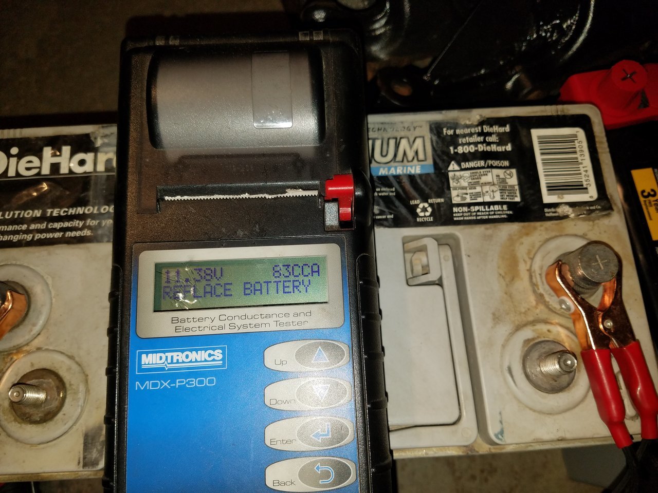

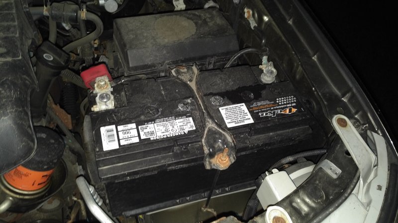

  14. Oct 17, 2017 at 9:16 PM
    #214
    MonkeyProof
    MonkeyProof Power Top
    Oct 7, 2008
    #9774
    12,792
    SoCal- SGV
    My Diehard Group 31M has nearly reached Critical Mass after nearly 8 years of care free ownership.
    There's an internal short happening making the battery hot to the touch just sitting by itself, especially at the terminals. This is after being removed from my junk 24 hours ago, still hot. Has also started to emit a rotten egg smell since removed from my Tacoma, all signs of a battery with a bad and/or shorted cell(s). Battery had been giving a slow crank at start-up and wouldn't hold a charge within the last week and a half that required a jump start most of the time. My little jump start pack has more than earned it's money.
    Didn't noticed the scorch marks from the gasses escaping until after removing the battery from the Pelfreybilt Battery Tray
    Only 83CCA lulz

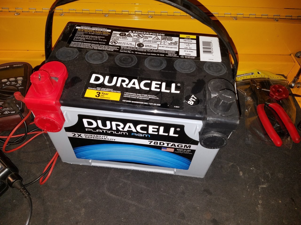

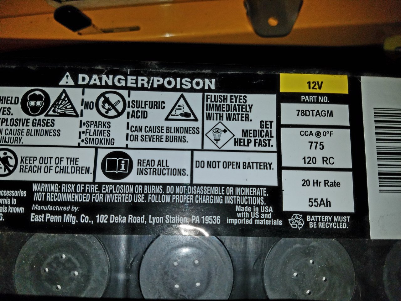

    After about 1.25 minutes of googling batteries because my short attention span, I decided to go with (2) East Penn Mfg. Co. Deka Batteries branded as Duracell Platinum AGM size 34/78 part# 78DTAGM. I got them at Sams Club for $129.88 ea. which has the absolute best price for this battery. This is the same exact Battery as the Deka Intimadator part# 9A78DT. The Deka battery has nearly identical specs as a Yellow Top 34/78, just way, way cheaper. Only difference in specs is that the Deka battery has a higher CCA rating at 775CCA compared to the Yellow Top CCA at 750CCA, and the Deka battery weighs one pound lighter than the Yellow Top.
    https://www.samsclub.com/sams/durac...ze-78dtagm/prod3590233.ip?xid=plp:product:1:2
    http://www.dekabatteries.com/assets/base/1737.pdf
    Listed below are known Deka and Deka Repackaged 34/78 Group batteries
    (list stolen from trail-gear.com)
    -Deka Intimidator 9A78DT
    -Deka Intimidator 9A78CDT
    -Deka Intimidator 9A34
    -Deka Intimidator 9A34R
    Duracell AGM Automotive Battery -
    Group Size 78DTAG
    -O’Reilly’s Auto Parts -
    Super Start Platinum
    Part Number: 78PLT
    Part Number: 34/78PLT
    -Auto Zone -
    Duralast Platinum
    Part Number: 78DT-AGM
    Part Number: 78-AGM
    Carquest Batteries - Next Generation - Extreme Service Part Number:
    NG3478
