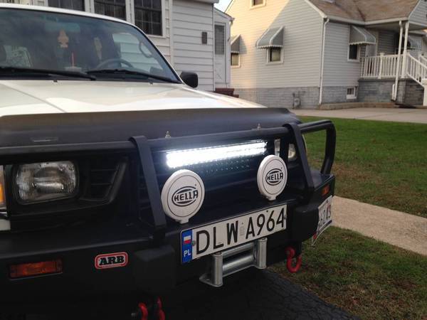

    :D So I know there are plenty of battery threads on here and I did search so please don't crucify me:), I couldn't seem to find a definitive answer. Is there a specific battery that is best for having lots of lights? With Christmas here there is about 3 sets of Led's on my list and I need a new battery anyway. Im running a Blue Sea Fuse Panel so no need for extra post or anything, just a general question. If it matters any I drive a first gen.
    [​IMG][​IMG]
