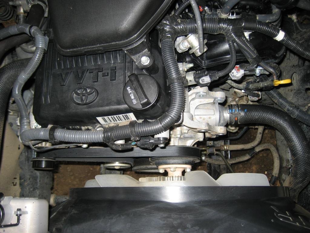

    I removed the AC compressor, power steering pump, long serpentine belt, and the fixed pulleys. So now I run a short simple belt where the crankshaft only turns the water pump and the alternator.

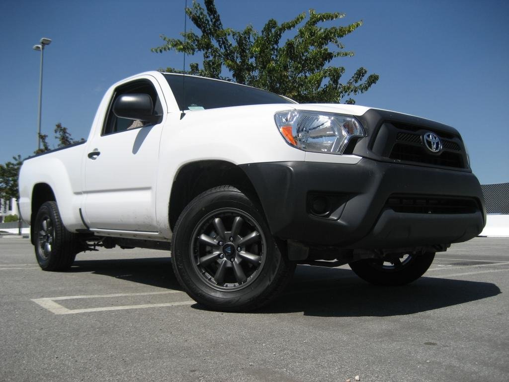

    For 17 years, I drove without AC or PS in my old Taco. I live and work in an unincorporated sparsely populated rural area and am rarely ever in the city, so I don't need either of them. Since performance options for these trucks are so limited, I focused on reducing weight and engine load as well as simple non invasive bolt on intake and exhaust mods. Latest fillup today was 25.3 mpg mixed street and highway driving on 87 octane winter blend gas. :)
