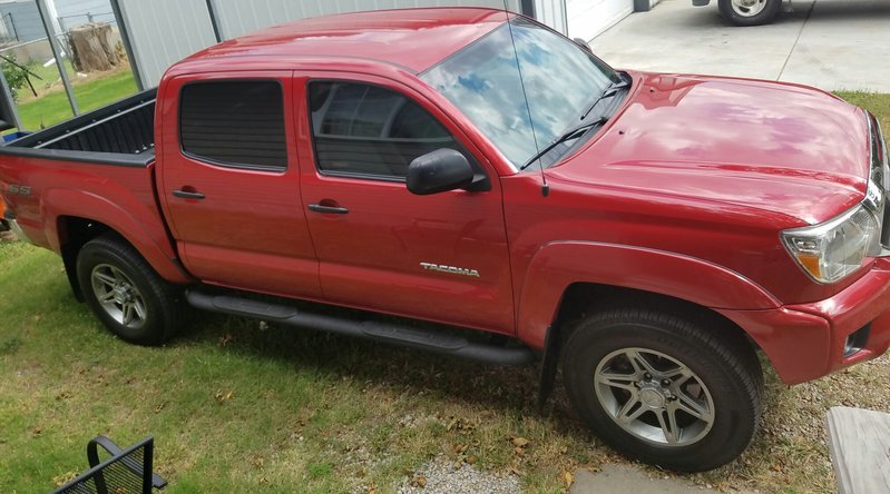

    Bought it yesterday 2013 I've decided on the Icon extended travel coilovers with the 700lb coils and the All Pro expedition springs so far haven't decided on control arms yet.
