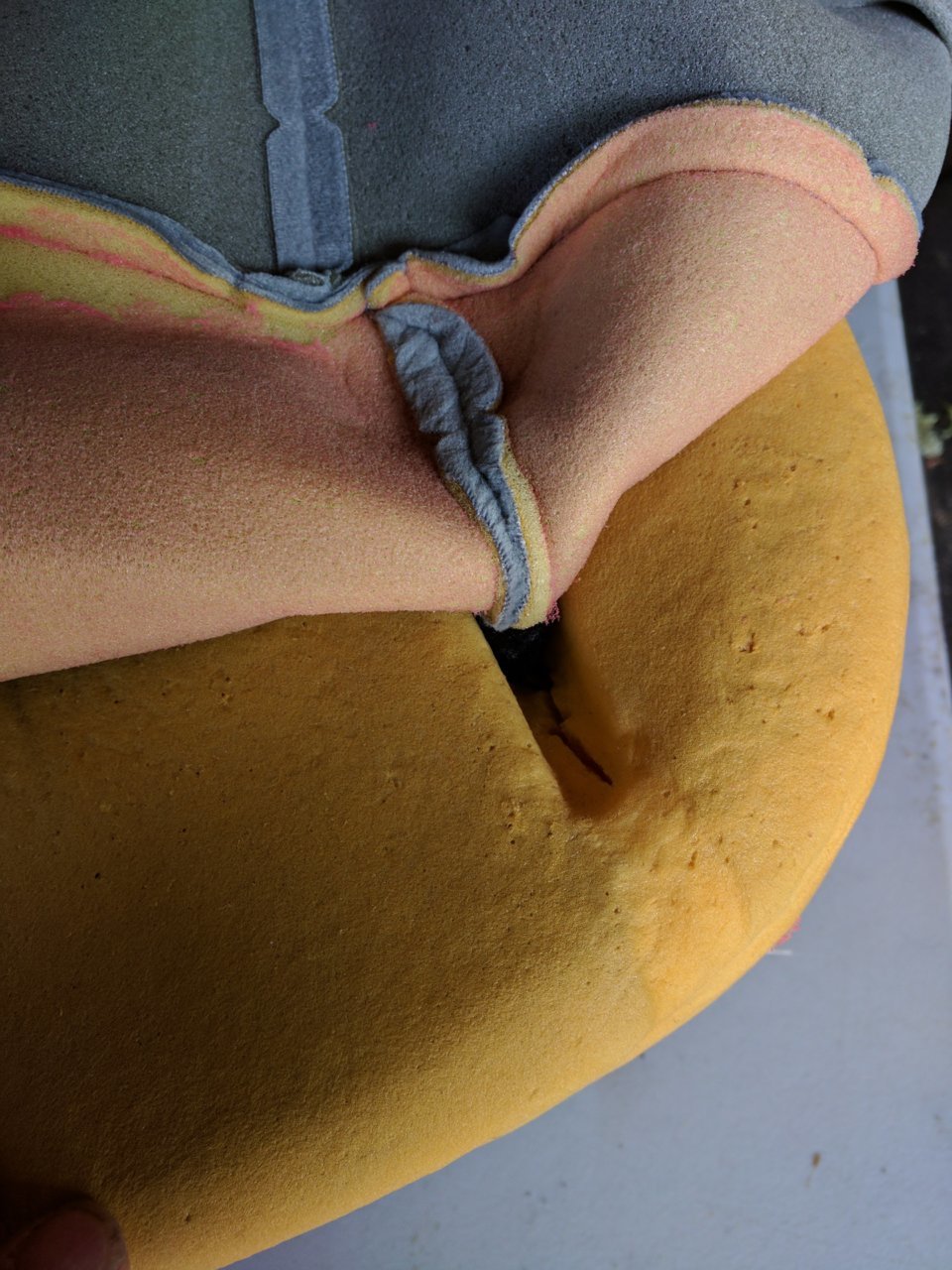

    - Anyway.. mark higher on the foam with a Sharpie where the cutout is for your horizontal bar's hog rings, just as I did above the bottom (2) pieces of yellow electricians tape
    - Here's another example of my marking up higher on the foam where the hog ring cut out is at

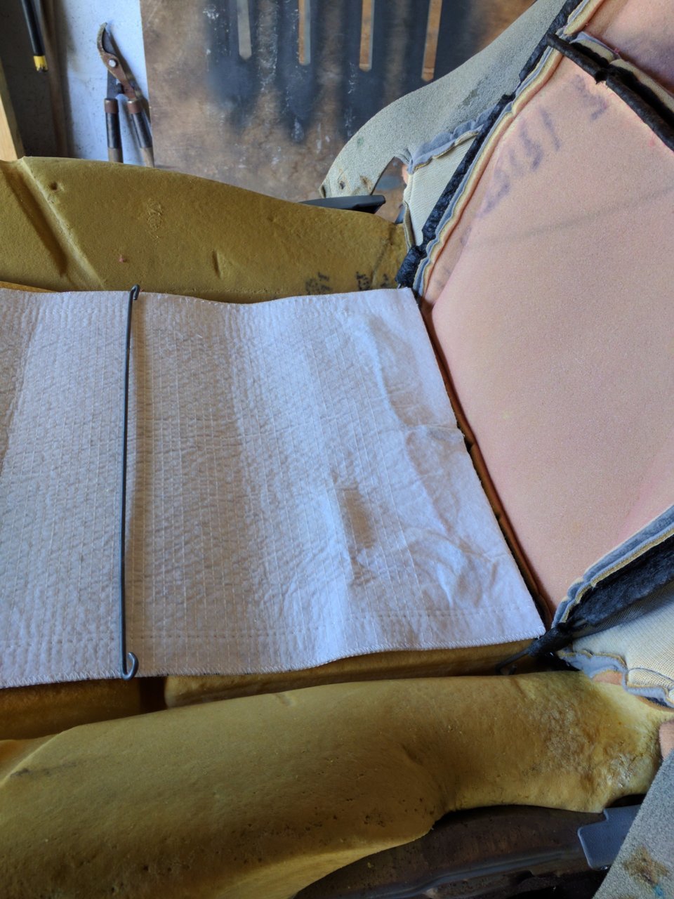

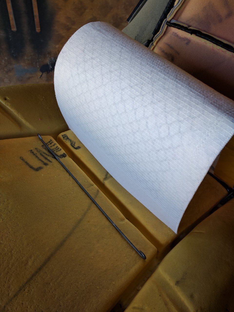

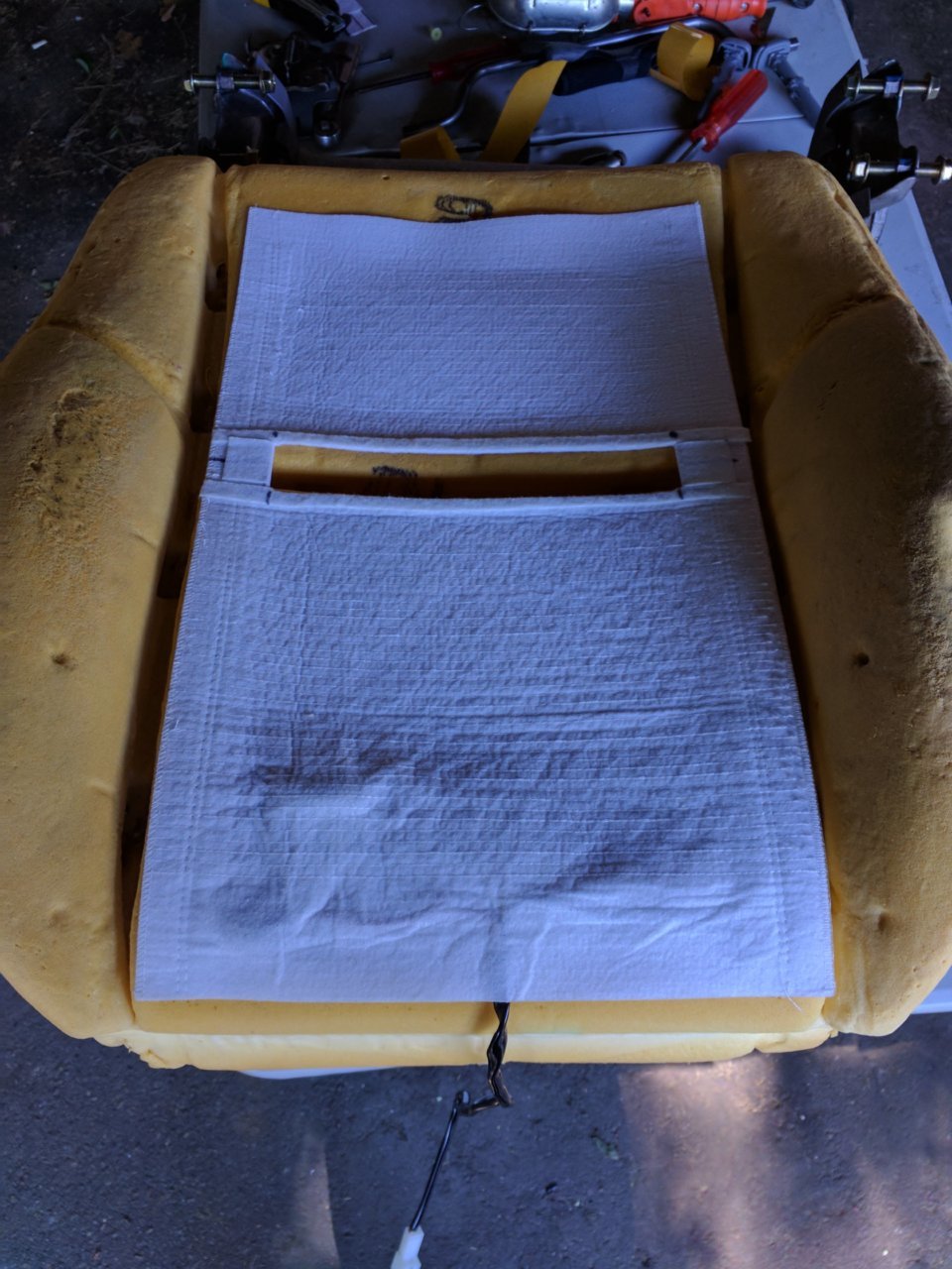

    STEP 2:
    - Position the heating element where you want it - if you want it more toward the rear, or if you want your hamstrings to get some heat too where the seat curves toward the front
    *This is not long enough to cover the entirety of the butt cushion*
    STEP 3:
    - Push the heating element into the crack and mark where you need to cut out for the horizontal bar and the hog rings placement
    - In the picture below you can see the outer edge of the hog ring cut out matches up with the edge of the box I'm cutting out
    - Near the tip of my screwdriver there's a thick black Sharpie dot --> I made this on both sides so when I have an known spot to wedge that heating element back in to the crease once I make my cut
    [​IMG]DSC_0017 by Mark Roberto, on Flickr
    - Again pictured here are the thick black Sharpie dots I was talking about above
    - The inner and outer (outer would be the edge of the box) hog ring cut outs
    STEP 4:
    - After you mark your heating element and cut out the middle section so your horizontal bar doesn't rub or get heated up and mess with your heating element it should look like this:
    STEP 5:
    - Make sure all of the heating pad stays on the seat
    - Anything hanging over I trimmed - I found this only to be necessary on the back cushion
    - You can see where I marked for trimming a few pictures above, and this one below highlighted by my handy scrap yellow electricians tape in the upper corners

    Just a couple pics. Get a pair of electricians diagonal cutters to cut out the existing hog rings. You'll need them.

    Thanks for pics. Does the metal cross wire go on top of or under the heat element?
  15. May 24, 2018 at 9:00 AM
    Larzzzz
    Larzzzz Grande' Ricardo
    Aug 23, 2009
    #21609
    2,842
    Larry
    MA
    '06 dclb 350+ kmiles
    Aux back up lights, Bed lights, Re-located trailer plug, Good dooby, a.k.a. jumper cable mod, Heated seats, back up camera,
    Under. I made a couple holes where the rod goes through the tube of the seat cover so i could sneak it under the sides of the heat mat.
    Edit: that rod arched up a little on the ends after I got the hog rings in the middle of the seat. I would suggest tape or shrink tube on the ends so that it can't possibly rub through and come in contact with the power running the length of the mat on the sides.
