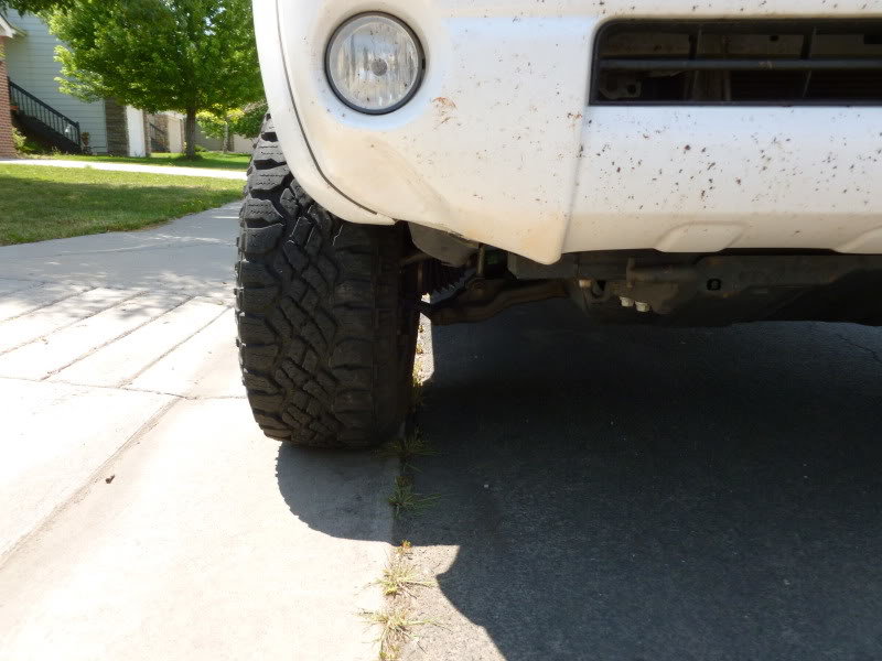

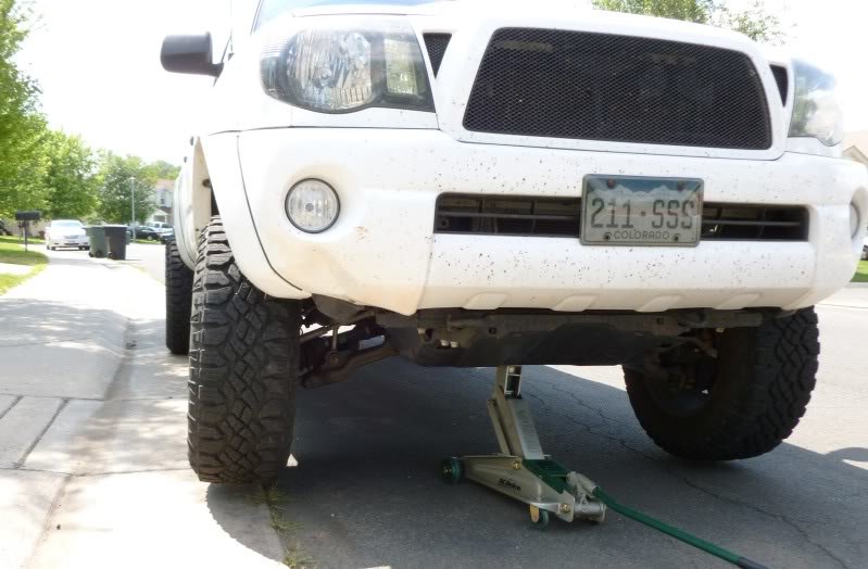

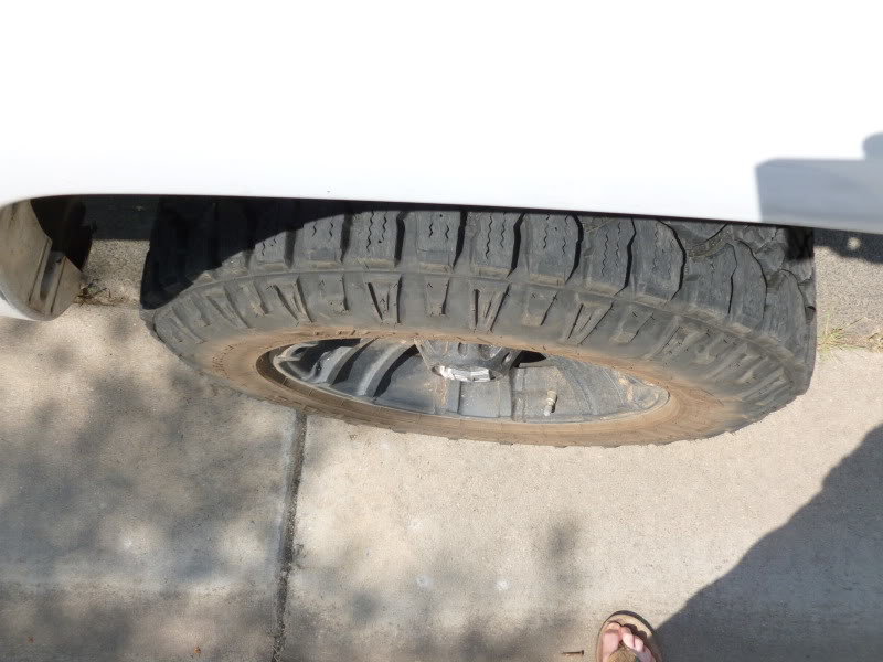

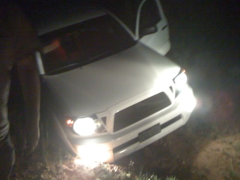

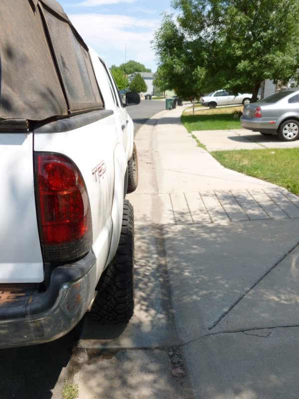

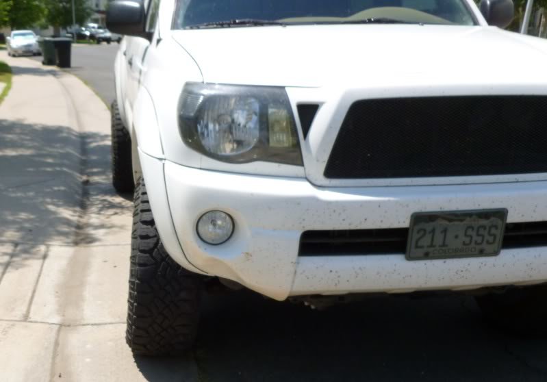

    Because I know how people like pics... here's the truck in the ravine... couldn't see it at night, on a flat area and on the passenger side of the vehicle. Note to self: get more lights!
    With full weight on, steering wheel STRAIGHT!
    outside perspective:
    top view, steering straight:
    all weight off the wheel to show how it hangs:
    back view, weight on:
    I also took pics of the suspension with the wheels turned back and forth, and compared it to the non-damaged side. Not to say there isn't something tweaked on the drivers side, but it seems to be straight by my eye.

    Might be a bent spindle. Thats what Aarons shit look like when he bent his. Well to a much worse degree.

    I do see that the sway bar is visibly bent on that side, which indicates the spindle could also be bent. I didn't get any closeup pics of that to look at more closely, but will try to compare the sides tonight.
