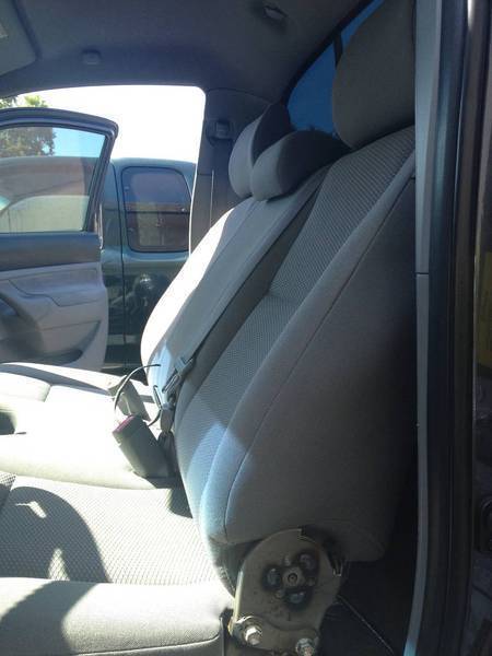

    ok so the other day i was wondering why the hell toyota didnt put a way to recline your bench seat?? i have the truck almost a year until i was like its either going to recline or im getting a access cab. so fellow bench owners here's a way to recline your seat while still being able to have it go back to stock sitting position!! that's right this will help you have two sitting positions!! keep in mind if you do this i am not in any way responsible for the outcome... now lets get started these are the tools i used: a screwdriver to take of the plastic on the edge of the seat covering the metal, a grinder to take off some metal simple as that...

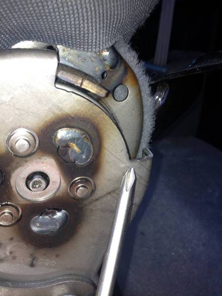

    this is a look at the side of the seat as you can see it has a about a 1inch piece of metal that goes up and stops when the seat is moved forward and down it stop where is the stock sitting position(pointing with the screwdriver).

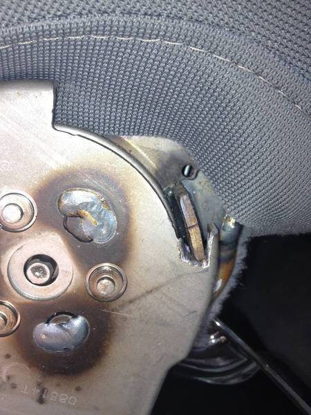

    now comes the fun part you grind the middle only (as seen on pic below) not the hole thing just enough for the metal that slides up and down to fit in the grove that you are cutting i cut about half a inch remember you only need to cut small bits to make this work dont go crazy!!
    once you cut down the metal should slide in place (as seen on pic below) the further the cut the more recline trust me you will be able to tell the difference with half a inch
    everything will lock in place it doesn't just sit on the metal it will actually lock in place like when its in stock sitting position. both settings will lock in place stock and recline and that's all folks..

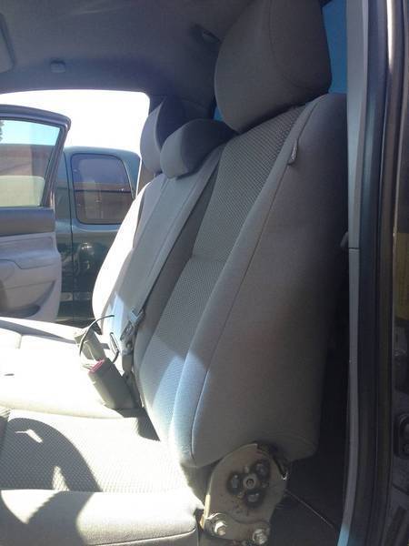

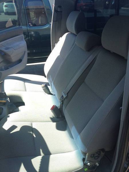

    reclined position top and bottom pic[​IMG]
