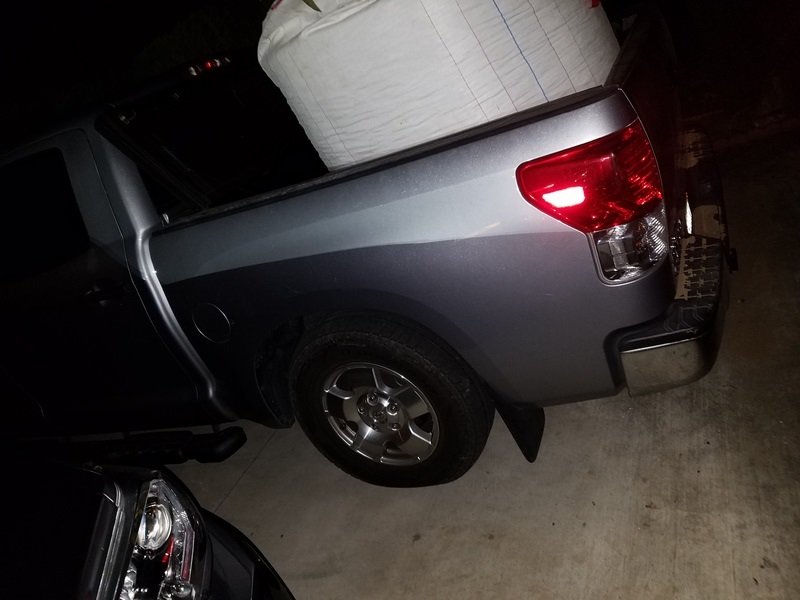

    1985 Hilux Crawler(Pete), 2016 Quicksand TRD OR 6MT (Wombat), 2016 TRD Pro T4R (OVTUNE # 2403)
    Mostly stuff I built.
