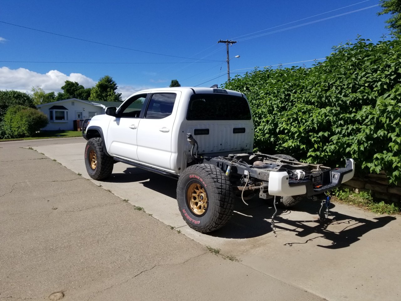

    Anyone pull the bed off of the frame on a third gen yet? Any advice?

    @90yota just did, he may have some pointers.
    90yota likes this.
  4. Jun 27, 2018 at 4:10 PM
    90yota
    90yota Instagram: 90_yota
    Apr 13, 2016
    #184183
    5,416
    Dixon, CA/Truckee,CA
    88 T4R / 15 F350
    Stock....ish

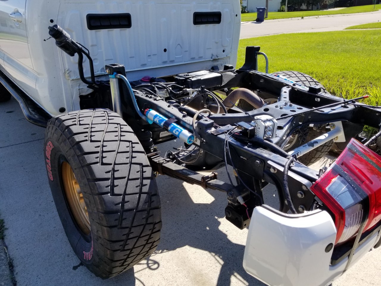

    6 bed bolts, remove gas cap (4 bolts), remove tail lights, bed electrical outlet, tailgate and camera. There are a few clips you must remove off the bed by the tail lamps. And its off. I dont remember the size of the torx bit required though. That will be the only special thing you'll need.

    I was looking into doing some rust proofing and rubberized undercoating. I'm trying to weigh my options for what would be the best method to coat the entire frame. It'd be much easier if the bed was off the frame.

    Bump. If I just pulled the 6 bed bolts, would there be enough wiggle room to slide the bed back a few inches? Mounting some items to the front of the bed, and just need enough clearance to snake a hand in between the bed and the cab to get some nuts on some bolts...

    Seems like there would not be enough slack in the gas filler and wiring harness for 'a few inches'.
    But I could be wrong, as I have not done one.
