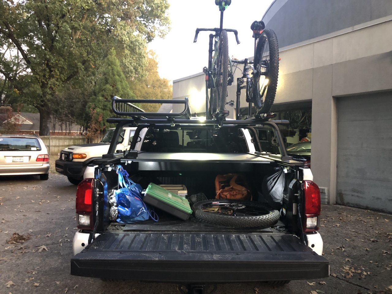

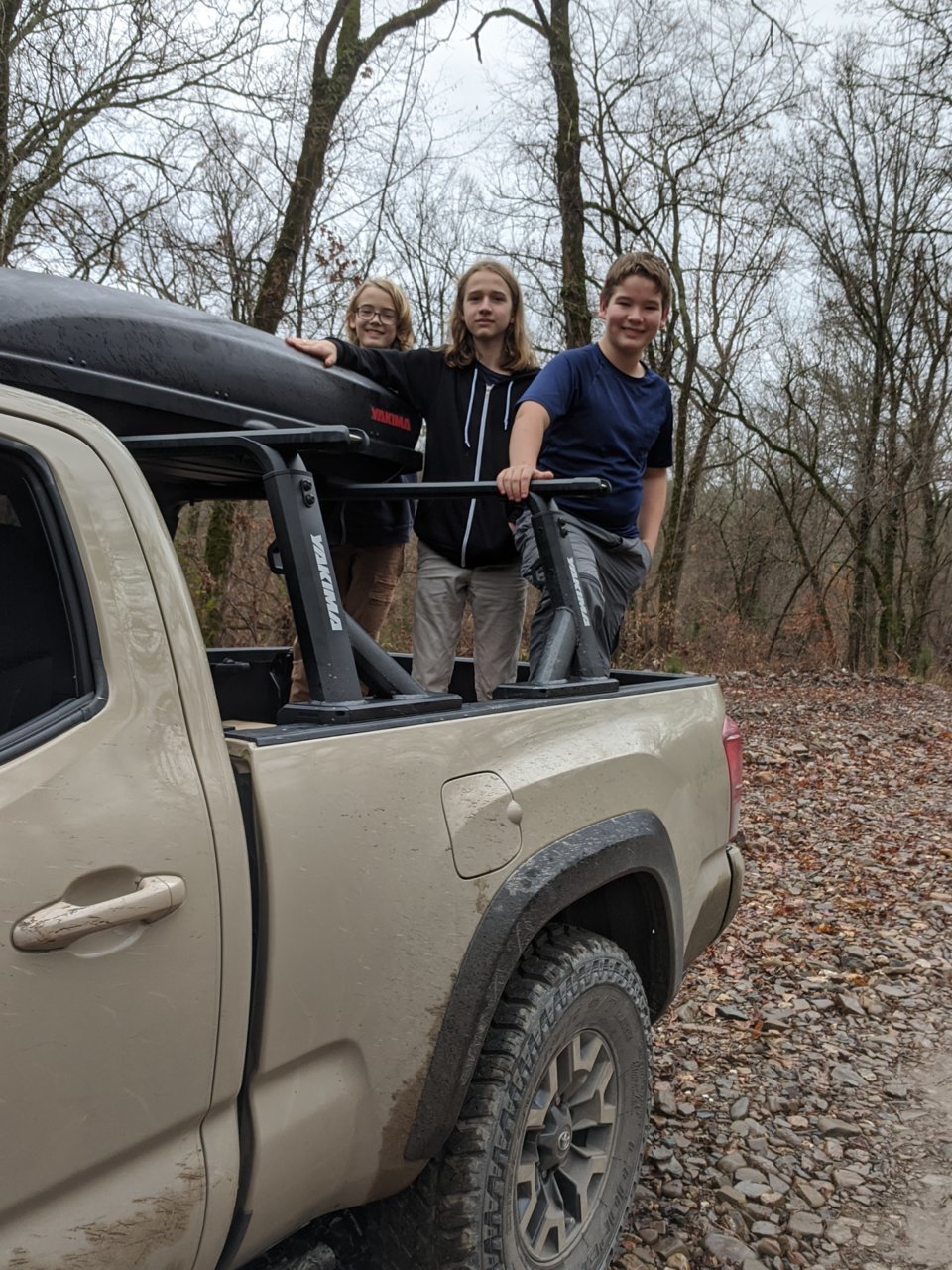

    It's not cheap, but the Yakima Overhaul & Outpost HD racks are easy to remove - I have the Overhaul and leave the front portion on all the time and add the rear when I need the full rack (currently just using it for a skybox since we're a family of five). 2 hex keys and the back portion comes off in about 2 minutes. If you got the additional side panels, 4 hex keys to loosen the mounting plates and the whole thing would lift off as one unit. The Outpost HD is fixed height and would put a RT Tent at the level of the cab. The Overhaul HD is adjustable height with the minimum height just below the cab. The height adjustment is easy but more like a 15 minute job - I raise mine when hauling long lumber or canoe. If you're not in a rush, REI has a couple of Yakima sales each year that are typically about 20% off.

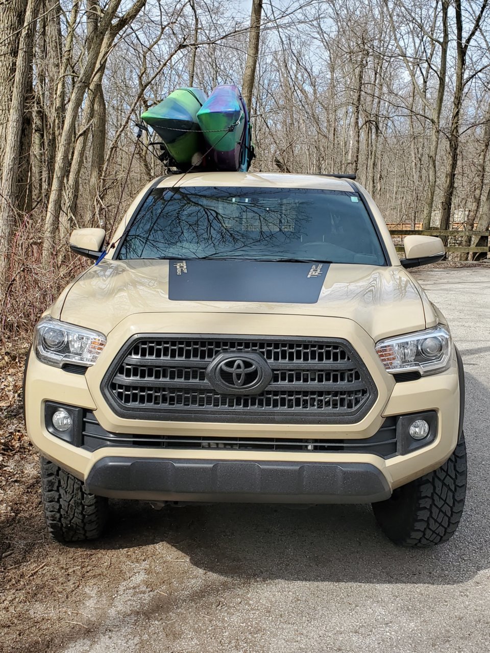

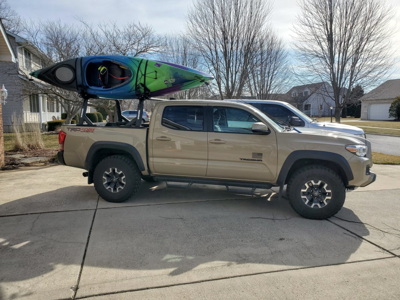

    I forgot to mention that I need it to handle a the weight of a tent on top. Love how you are able to carry all the kayaks.. need to see more how you're doing that. After looking closer, it looks like you carry two kayaks total?
    I carry two now but I'd like to be able to carry four or five.

    Yeah, with the Prinsu over the cab (with "stackers") I can do 4 boats on the cab, then I can easily carry 4-5 more in the bed / on the racks. Somewhere I've got a picture of 8 boats on the truck, running shuttles for whitewater trips.
