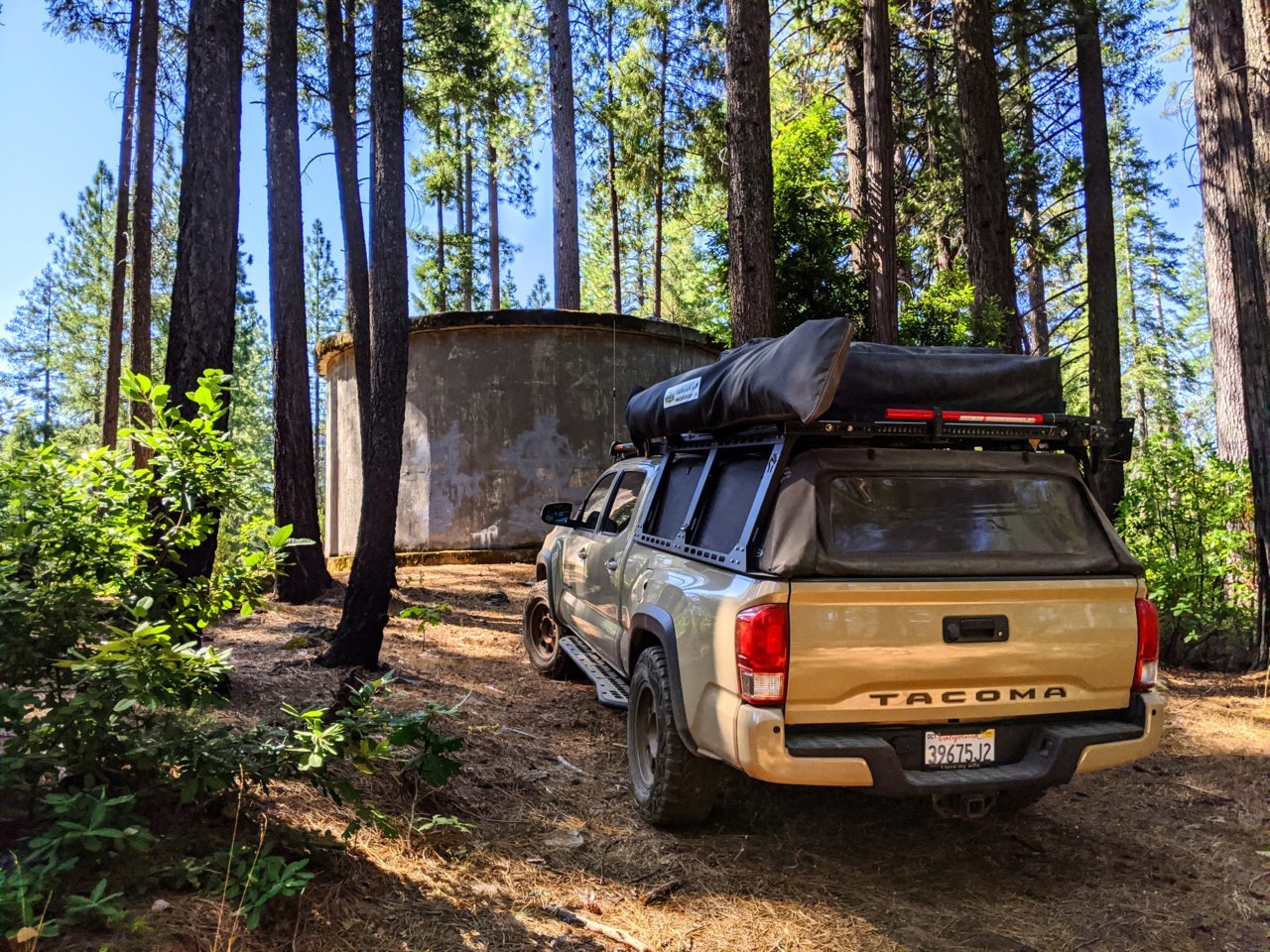

    Dissent offroad makes a aluminum version as well that goes over the soft topper. I can’t speak to the other brands, but it is challenging to retract the soft topper with the dissent bed rack installed

    Nice. Thanks for the tip -- I remember seeing something from this dude on the Forums and I thought he had stopped making them. Regarding the rack getting in the way, I know that some brands (most notably UpTop) says to remove the middle truss bar if you're going to be retracting the Soft Topper. Probably hurts your overall load capabilities, but I'm not sure I care that much. Thanks for the info! Any more pics you have would be super cool -- particularly how it mounts (I assume under the SoftTopper rails, but I'm always curious)

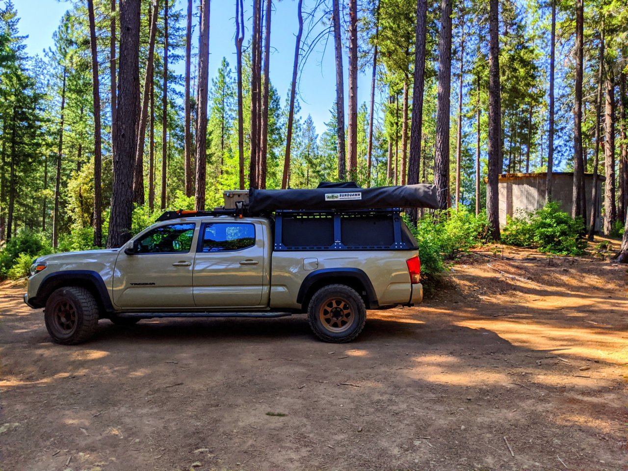

    I've got the Mobtown offroad rack and love it. I'm not super into the blocky modern military look that the other options give, hence the reason i went with the mobtown. I plan on ordering the side panels eventually, I think it will complete the look of the rack and really offer some much needed storage on the outside of the vehicle.
    Pros:
    +looks great on the truck!
    +Assembly is very straight forward
    +simple design that makes sense
    +sits low and pretty snug to the top of the soft topper
    +quality construction
    No cons really, just some things that bothered me a little:
    -the mounting brackets that fit into the track system were too tall to fit, I ended up having to spend some time with a grinder taking them down to make them work.
    -came up short on some hardware when everything arrived.
    -there's a little bit of porosity in some of the welds(wasn't noticeable until after powdercoat until rust started creeping through)
    My final opinion: Great product, customer service and communication was pretty on point, wait time was a little longer than expected, but I'm happy with the end result. They're a small shop that's doing their best to meet a high demand, in a trying time for a well designed and built product. I think they could focus a little more effort on quality control before sending the product out the door.
    As a former metal fab shop owner, I fully understand what they're going through with vendors failing to deliver which delays their delivery schedule. I couldn't imagine dealing with what COVID caused when half the country is shut down, so I applaud them for even managing to stay a little bit on top of their game during the shit show of 2020.

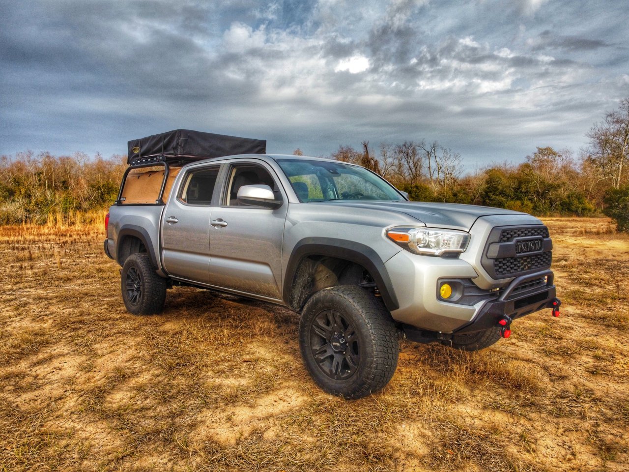

    I have a Dissent Offroad rack. It's absolutely fantastic. The nuts are pressed in which means to install it, you just need an impact with the right socket. Took me maybe 1.5hrs to install the softtopper and the bed rack.
    That said, his only options for mounting things on the side of the rack are retractable doors, which don't work for my setup, so I'm having to make my own side rails to mount rotopax and maxtrax.
    Quality is top notch though. As far as Ben still making them or not... I doubt he'd stop. But, you can always call him and leave a voicemail. He got back to me within 24hrs most of the time. Nice guy. His operation is growing last I heard, which is a good thing.
    Also the price point is very good for the quality you get.

    Man, those look fantastic, thanks for the high quality pics! Yeah, I'd love to support him, but I'm not sure I have time to mod things, and I defintely want to mount a few things (really mostly just water, shovel, and trax). Love the fist logo, too.
