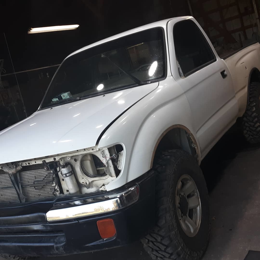

    15
    This is my 1998 Tacoma 3rz-fe
