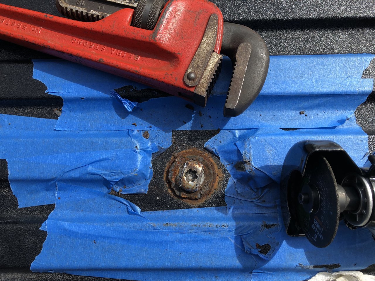

    2009 and the bed bolts (6) had major rust and flacking under my Tacoma bed mat so I pulled them out today. Cost about $10 each online OEM part # 64189-0C011 and head is T-55 star if you can get ahold of it. For the worst one the bolt head hole was a mess and the T-55 was loose/stripping so I used my Harbor Freight cutoff wheel to make 2 flat sides and then used a large pipe wrench and out it came a half turn at a time with major torque applied. The bolts are threaded in at least an 1" and you have about 0.25 inch hanging out below the frame nut that is really a rusted mess to get past. I used rust remover to clean around the holes and a screw driver to ream the major rust crap out of the metal insert in the bed followed by penetrating oil in the nut. Anti-seize was applied to the new bolts and they easily screwed back in. A pain but looks good now and no dripping rust anymore.

    Way easier to just weld a 3/4" nut on the top of it and take it off with a 1/2" impact, for future reference

    Nope, it didn't on mine and I welded the nut all the way around in one bead without stopping, too. If you were worried, tho, you could weld a small bead, let it cool, weld some more, let it cool, etc.. but like I said, didn't do a thing to mine. I hit the nut with an air gun to knock the dust off, soaked it in PB blast overnight, welded a nut onto it and zipped it right off. And mine has been a farm truck for 7 years, so it was real boogered up and rusted.

    As for welding a nut on great idea but no welder so this was tools at hand. Pulled my shell off too to reseal the front and will post pics of the front seal and Tacoma open seam that allows most to leak thru later also.
