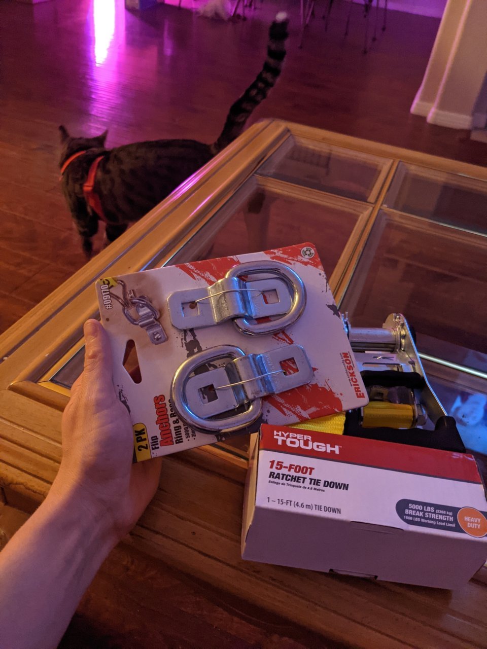

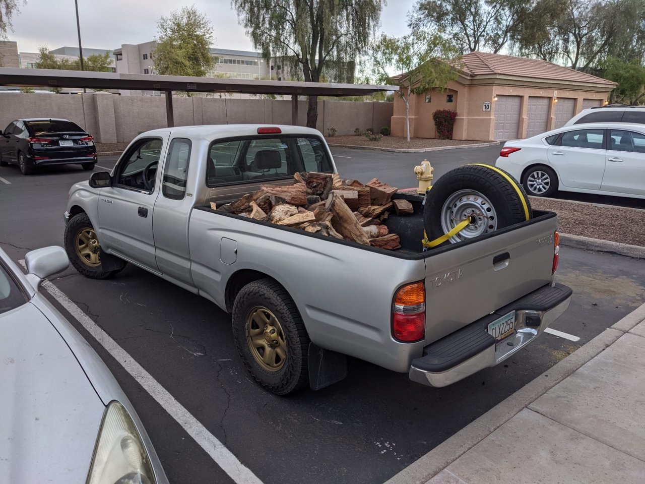

    Grab these, tap the bed, use some grade 8 or higher bolts, done. I made a backing plate for extra beef
