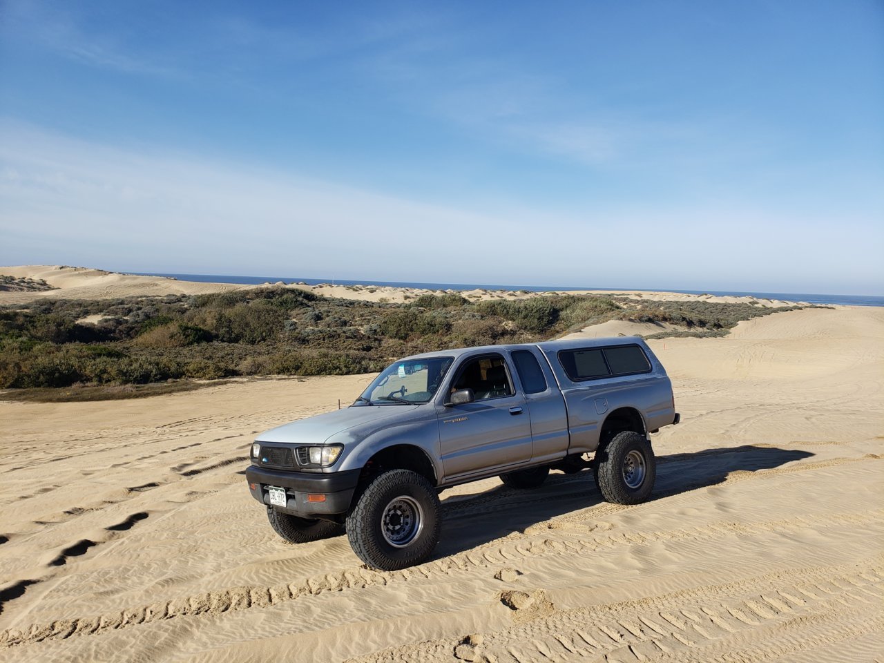

    during my trip thru cali I spent a day @Oceana Dunes. Started at 23psi dropped down to 12 after a few.
