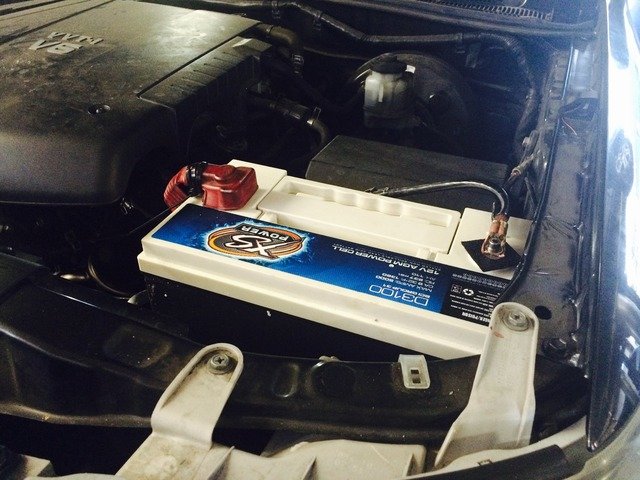

    Xs power d3100, northstar AGM 31D is best for our trucks with higher current draw demands

    Thanks. I also plan on doing the big 3 upgrade when i upgrade my alternator. I need to replace my battery since my current battery is dying.

    Have you installed the xspower d3100? How is the fit?

    Fits nice and snug, but it fits.

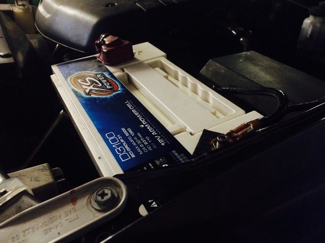

    Thanks. Should be getting one in a couple days. Looked at the specs and its damn heavy

    The 2700 is also a wicked battery,
    I used both the d3100 and the d2700 in my truck

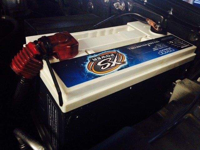

    Weighs in at almost 80lbs., but it fits,
    and it rocks. I'm done with stock factory and auto store batteries.
    Free shipping with Amazon Prime; I only had to lift it into the truck.

    Would the battery tie down fit?
