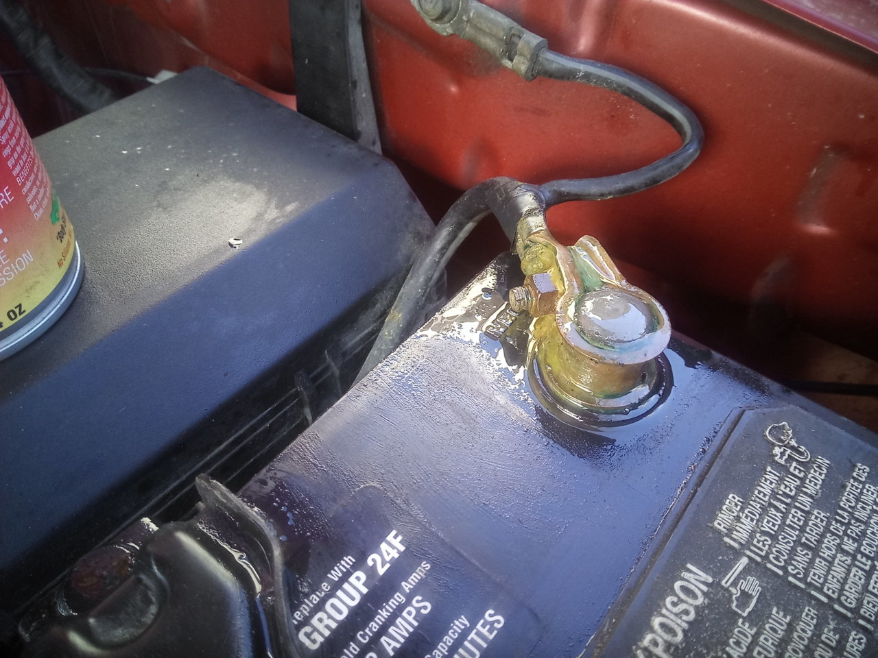

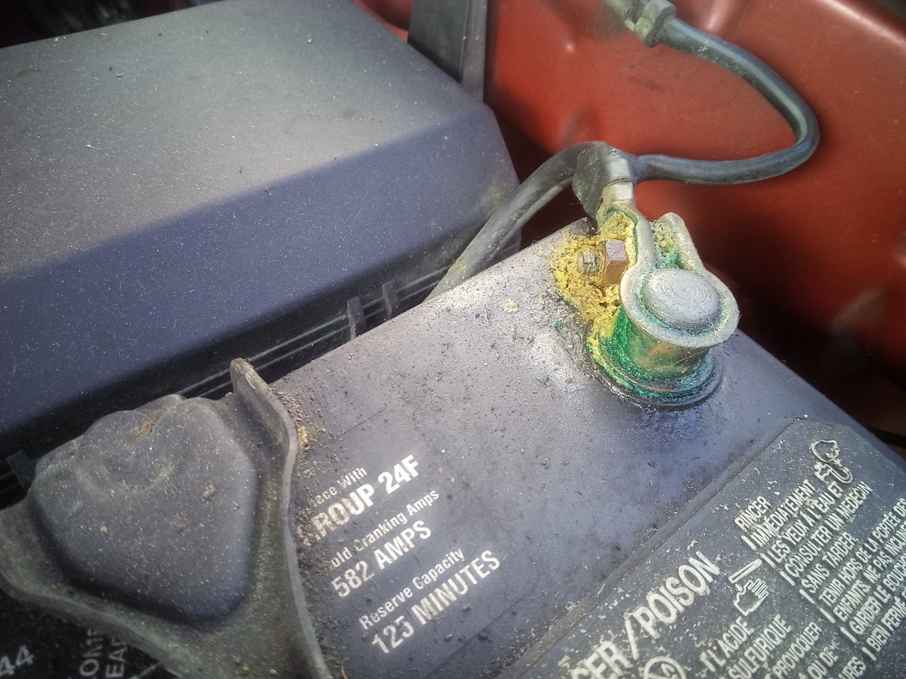

    FF seemed to dry up after a year or so and greenish stuff started to sprout again
    Stock battery on relatives 2011 still working after almost 10 years!
    Wiped with shop towel and trying some nutz lube spray to see how it goes
