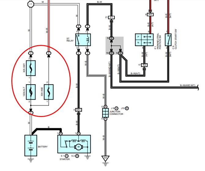

    Yeah you may want to check the big 3 highlighted. If the 1st gens are anything like the Camrys then AM1 and maybe even AM2 fuses will be buried deep in the dash and an absolute nightmare to get to. If all of the highlighted fuses fare out okay, then suspect you fried your PCM, but don't cross that bridge until you have eliminated your first possibilities. Best of luck in your endeavors.

    Replaced the alternator? What diagnostics/signs pointed to that? If the wiring wasn't changed there should be fuses between the battery and alternator.
    Glad you're back up and running
    Edit: Here's a page of the Overall wiring diagram that shows the Alternator(Generator) circuit
