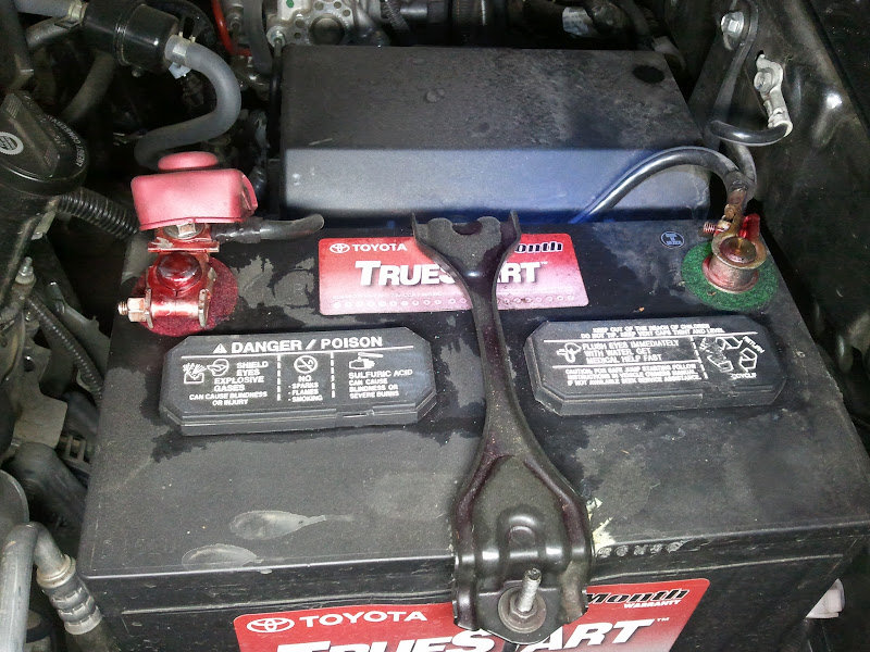

    My battery started leaking acid pretty bad this week and removed some of the paint around the battery tray and off the frame. Before I replace my wheel well splash guards I want to repaint these areas the best I can. I don't need much but is there an afforadable chassis paint that's an all in one. I was looking at por-15 but it's quite expensive with having to buy the rust preventative and top coat. Also around the battery tray area the clear coat was basically removed and I was thinking of a clear spray paint or something as it's not too bad. Any recommendations?

    My battery was leaking around the positive battery terminal and boiling out the seams on the same side. After getting a free replacement at Autozone I checked out the reviews and it seems that others have had the same problem with this particular battery. Hopefully it last more then 2yrs.
