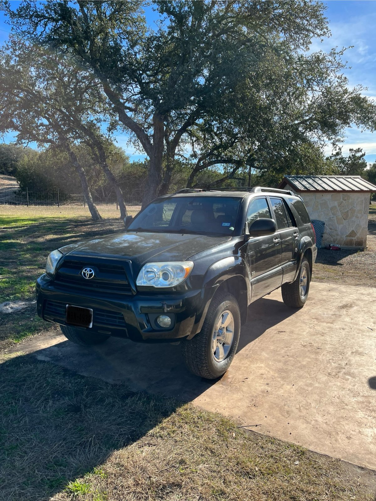

    Here’s my 2006 picked up recently from a family member with 207k miles. The plan is to leave it mostly stock and make a nice driver out of it.
    How it sits today
    Early pictures
    Did head gaskets at 193.5k miles about a year ago. It was puking coolant into the overflow and then the radiator would get low and it wouldn’t pull anything from the overflow back in. Did the basics during this job like timing chain guides, water pump, hoses, thermostat, etc.
