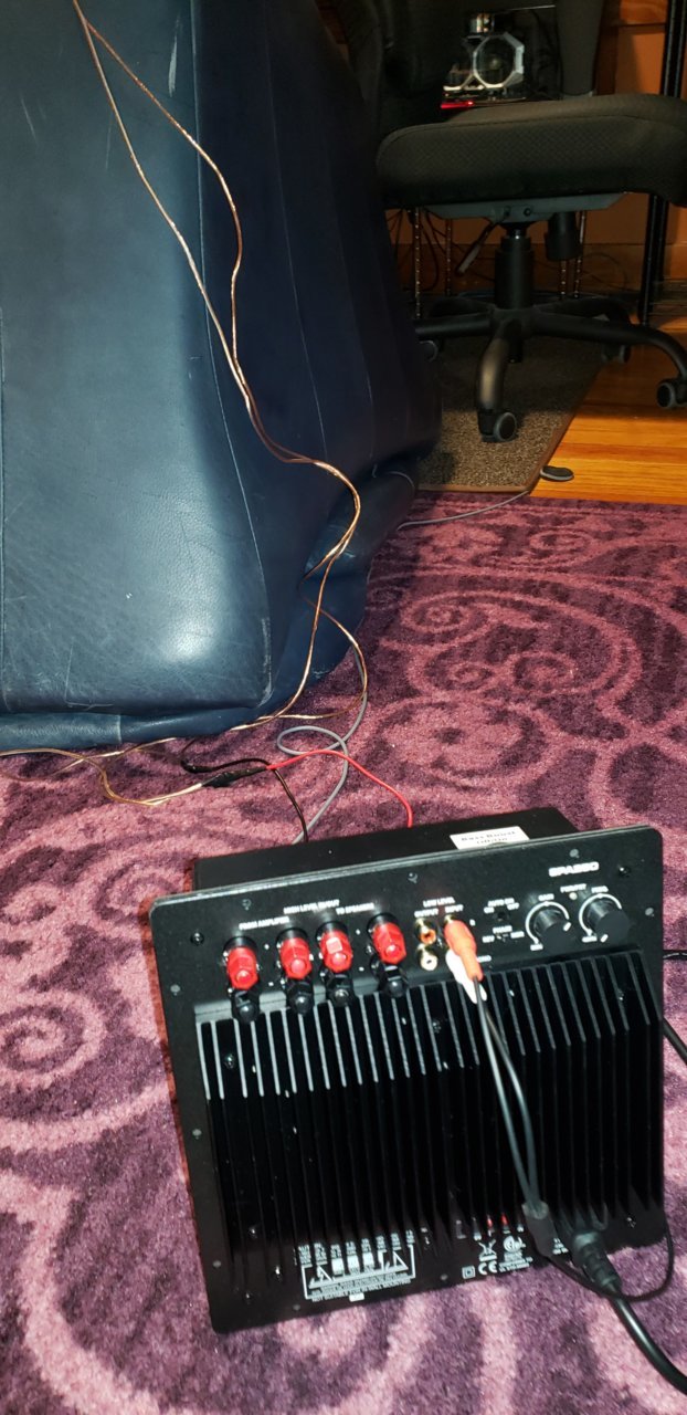

    I installed all four units inside the back of my game-room lounge chair, which has a pretty solid all-wood frame:

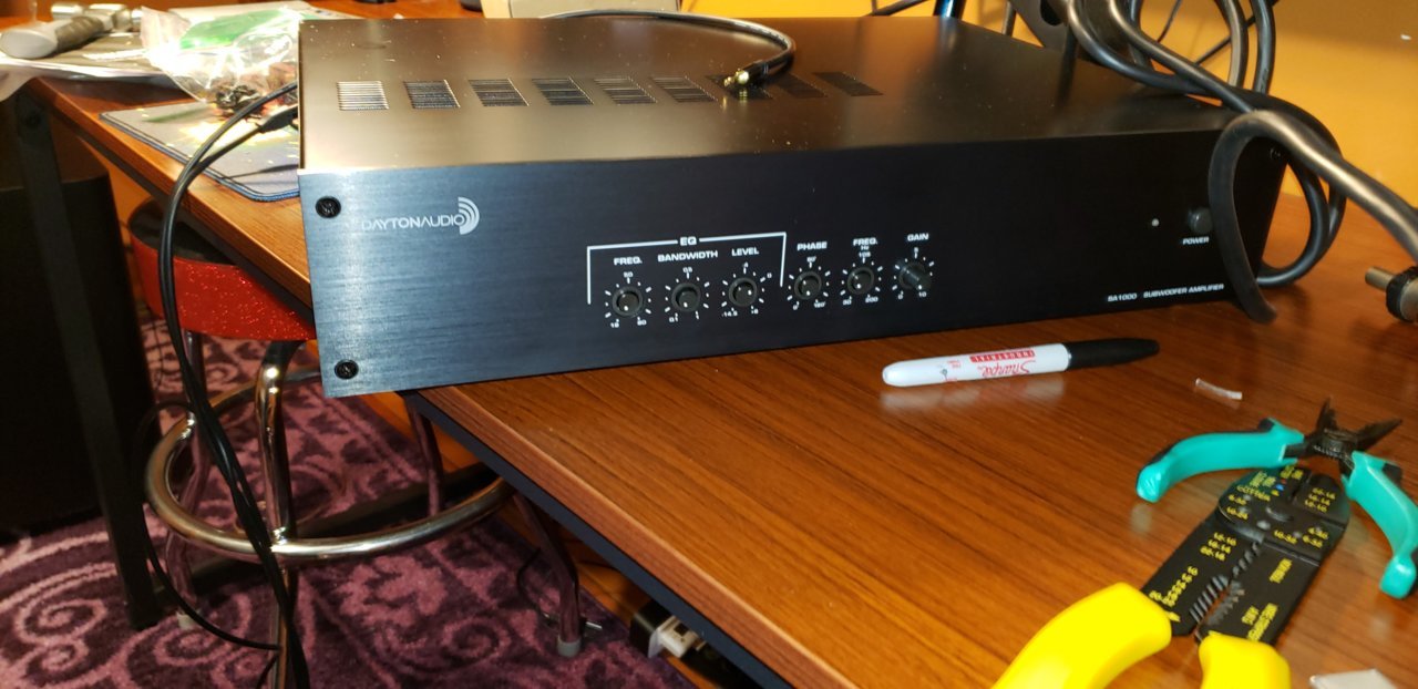

    After I got done with this, I decided that bass-shakers are the secret to happiness, and I fell in love with the things. The Auras are only rated for 50w RMS, so with the gain at about 70% these worked GREAT for movies and music using a 250w plate amp. But these units are most responsive at about 32-34hz, and responsiveness drops quickly outside of that range. I wanted slightly more low frequency response, so I leveled up and also bought a Buttkicker LFE paired with a SA1000 mono AB amplifier.

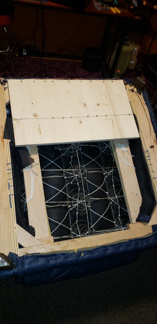

    I mounted the Buttkicker to a 3/4 piece of Birch plywood, and sealed the bottom of the chair cavity so that the Buttkicker was oriented in it's default upright position:
    It looks a little janky underneath, but it's solid as hell and looks fine in front of my TV. Theres a 15" Dayton sealed sub right behind the whole setup to offer a tad bit of little real SPL to the room.
    Anyway, DAYUUUM, the Buttkicker obliterates the performance of the Aura units. The Buttkicker is responsive down to like 5Hz all the way up to 30-32hz, which compliments the Auras exceptionally. The 18-24hz range played on the Buttkickers with that SA1000 will shake your walls down if you don't use some kind of kinetic isolation feet on your furniture, but it's insane how quiet all of this is from other rooms in my house (unless you don't use isolators, in which case it'll shake everyone in the house). For real, the Buttkicker is amazing.
