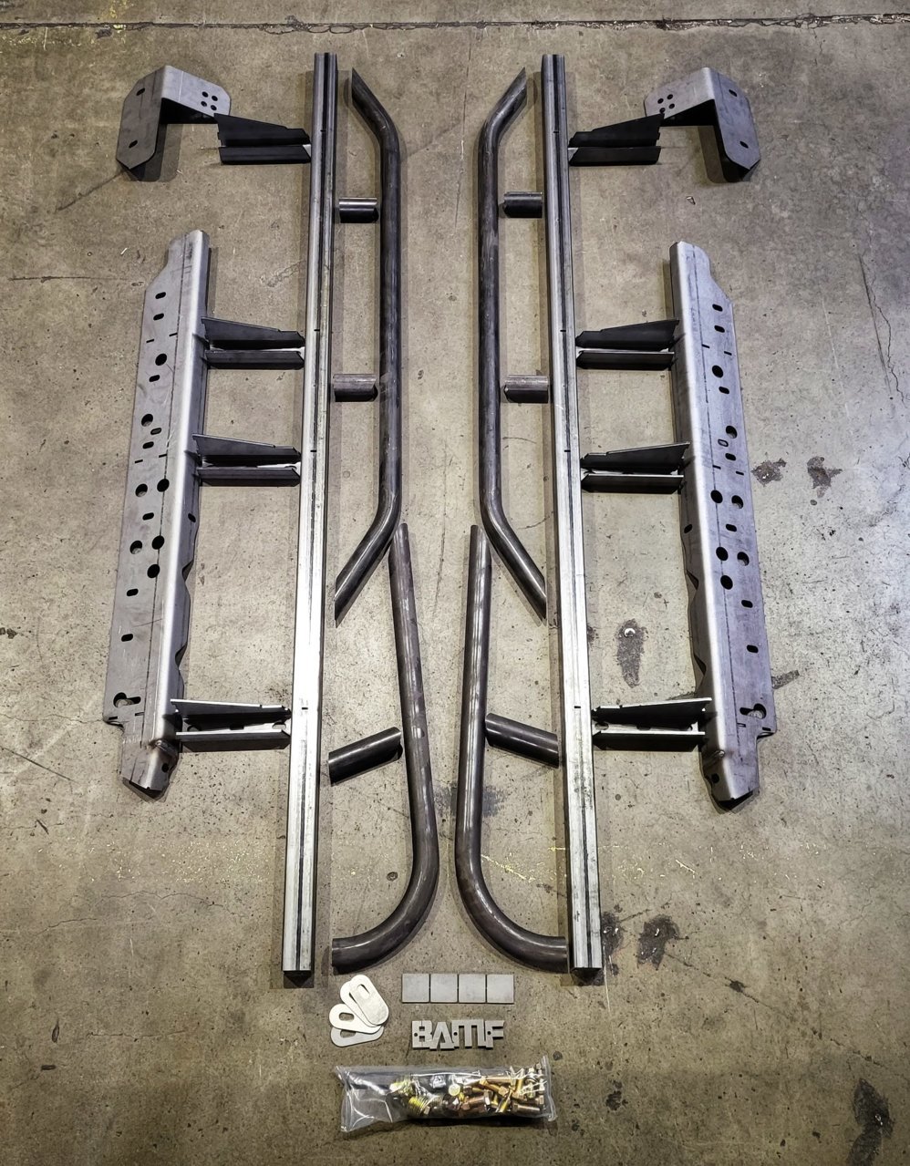

    Everything's up! lead times, Freight, materials, Labor. Bolt on sliders are well over $1000 bucks shipped nowadays.
    We have held off on larger DIY parts for some time. But were dipping our feet in to test the waters.
    Kits are on hold do to shipping issues too BAMF for boxes.
    What's included in the kit.
    All CNC laser cut/formed parts ready to weld
    2. 80" 2x2x.120 Square tubes with .120" cold rolled caps
    2. 1.75"x .120" wall DOM main tubes
    2. 1.75"x .120" wall DOM Kickout tubes
    6. 1.75"x .120" wall DOM spacers
    8. .188" HRPO laser cut and formed legs
    2. sets of .188" frame mounting plates
    2. BAMF logos
    1. Hardware pack for installation
    20220623_091310-01.jpg 20220623_091356-01.jpg 20220623_091403-01.jpg 20220623_091408-01.jpg 20220623_091432-01.jpg 20220623_091516-01.jpg 20220623_091530-01.jpg

    I just received my kit today and was just wondering what are the 4 square metal pieces that are connected together and the 4 metal oval pieces with the hole in them are for

    I’m assuming the squares are to block off the main squares tubes.

    ^correct.
    And the 4 oval pieces are spacers for the two forward vertical mounting holes on each side. You need them on third gens due to a raised portion on the corresponding frame gusset. You can weld them to the inside of the mounting plate.
