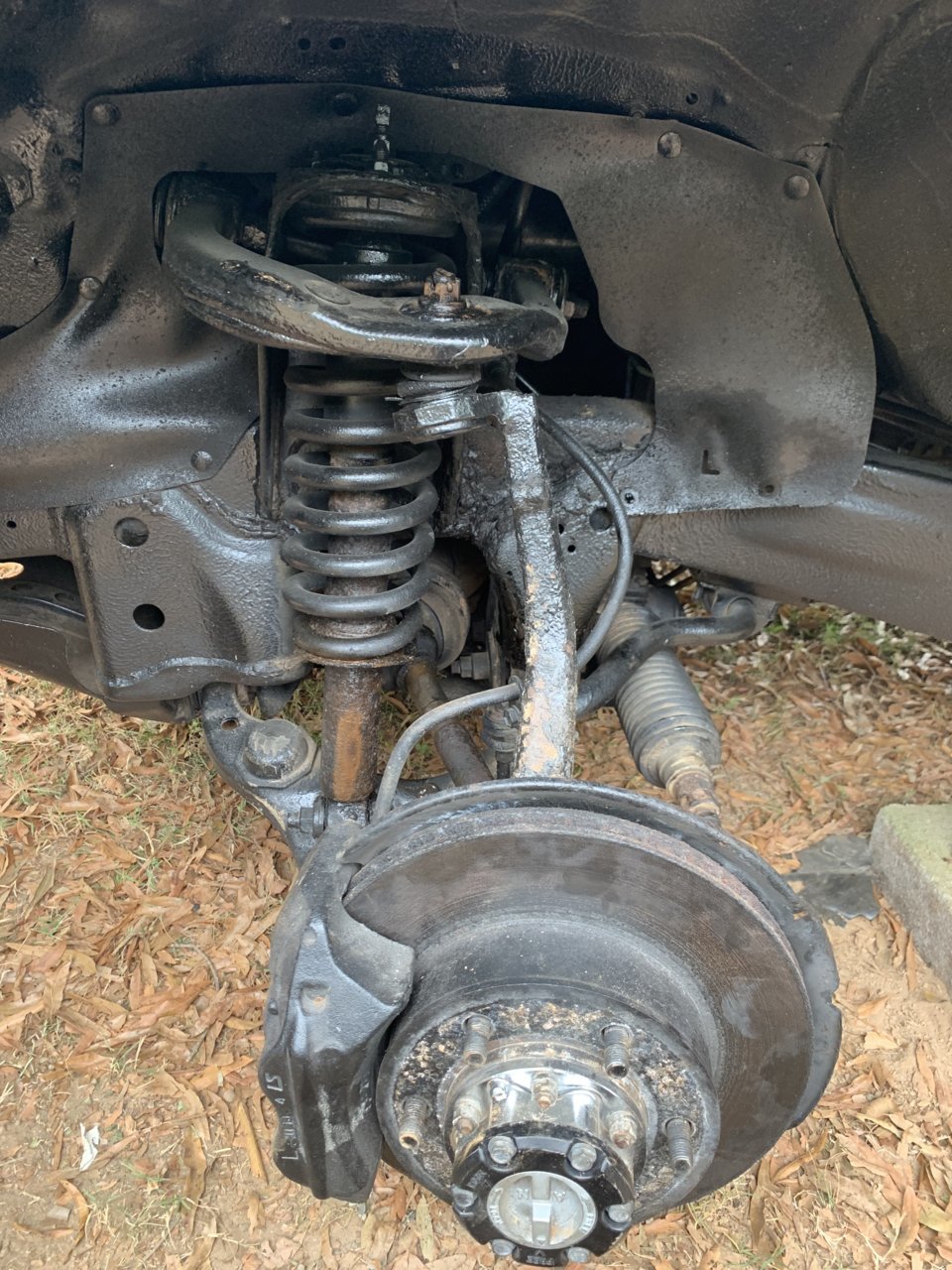

    6B6D233D-1405-4C6D-9137-F43FE814916B.jpg Well, i was driving down the road the other day when the driver side lower BJ decided to give on me. I didn’t notice at first but it appears that something happened to the cv axel in the process. I was wondering if someone could give me some advice on doing this job? Since the BJ is broken, everything moves when I try to wrench it and I’m not sure how to hold it still. Also is the CV damaged or can I pop it back in? I’m not a mechanic by any means. And yes I know everything is covered in rust/ undercoat. Previous owner was trying to hide it. Any advice on how to do this is greatly appreciated

    A few things.
    1. Bummer, sorry you had this happen.
    2. When you replace the LBJ, do yourself a favor and replace the passenger side as well. And use OEM LBJs so you know you're putting in something quality. Order these parts: L (driver): 43340-39585; R (passenger): 43330-39815
    3. Use this write-up Installing new Lower Ball Joints (LBJ's) to see what you need to do. I'd recommend purchasing the tools listed there since they are good to have for a lot of work on our trucks, but you can likely rent them from a parts store as well. when you're trying to get the castle nut off of the bottom of the ball joint where it's secured to the LCA, just use a pair of vice grips on the top and an impact wrench (24mm socket I believe) on the bottom castle nut. Don't forget to remove the cotter pin first so the nut can spin off.

    1st off ball joints don't usually just fail without a warning (vibrating, clunking, steering problems, etc) so I would 100% replace both sides because your other side is probably ready to pop.
    Now as far as fixing things, get TOYOTA ball joints. If you absolutely cannot afford them then get Moog Problem Solvers (closest to OEM quality as possible). Your CV axle is probably okay so long as the boot isn't torn, but depending on how many miles are on them I might just go ahead and replace both of them. Looking at the pictures it appears your knuckle has bent and your upper ball joints are cracked. I would replace the knuckle on the drivers side and the ball joints on both sides. To get the bottom joint off I would see if a good pair of vice grips can hold the ball or you can get the old grinder out and cut it. I would replace everything on both sides and call it a day!
    It sucks this happens on these trucks (I've personally seen 3 on the side of the road) and I am sorry this happend to you. Nothing is unfixable!

    Fortunately, a lot of people are here to help so don't fret!
    Lots of great advice to be had.
    While you're in there; your tie rod ends, sway bar end links, and suspension need some help (replacing) by the looks of things.
    If you're not holding alignment, I'd look into replacing your lower control arm bushings and cam bolts since you're working on the front end anyway.
    Worst thing you can do is take apart the front end multiple times for each individual job; knock it all out at once I say.

    OME and worth every penny.
    I agree the spindle looks bent from what I can tell in the picture and there's no way I'd trust that upper BJ after what it just went through.
    I do wonder with these incidents if you had kept a watch on the dust boot of the BJ that it was intact or if all these failures are a result of dirt on the ball wearing away the socket?

    Hey, also in that first pic your lower spring seat looks pretty rusted. I have seen those give way and break off the side of the shock. You may want to evaluate it pretty good and replace if it looks like it might fail. That shock looks pretty old, so may time anyway.

    If you have any plans to go to a solid front axle now might be the time.
    Find some one that just did one and has all the parts to get rid of .
    Sometimes it is hard to make a call about just what is Fubar and needs replaced unless your up close and in person
