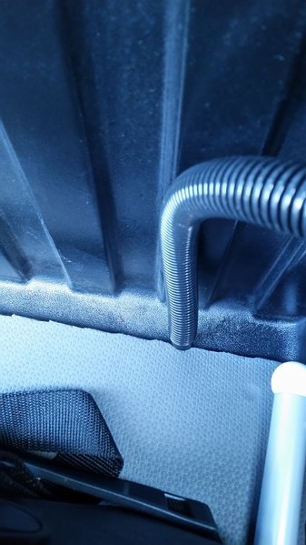

    You can drill holes if you want but what I did was just let the tubes drain under my bed Matt and out the holes in the bed!!!

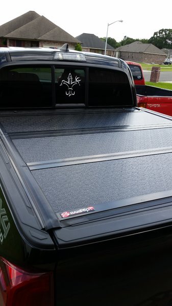

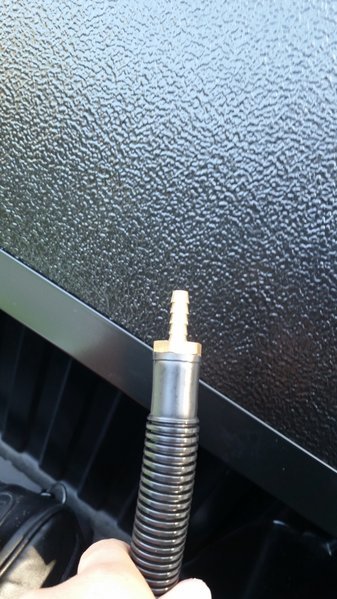

    Here is how mine look like 4$ a peice at home depot! Cover looks great locks good I added a pop a lock for the tailgate definitely recommend that! Love it but font expect it to be waterproof water definitely leaks on the side walls bed matt keeps everything dry. Got it from Morie from tonneau factory outlet gave me a great deal and awesome service

    Any idea what sizes for each end of the brass fitting (or a part no.)? If not, ok. It would be nice to go ahead and pick them up from the hardware store prior to receiving my BAKFlip so I can install everything just once and be done with it. Thanks in advance.

    Don't remember exactly it's 1/4 on one side either 3/8th or 5/8th
