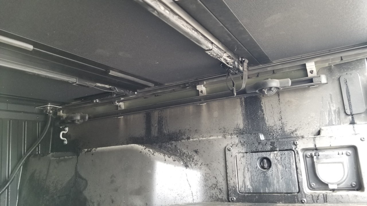

    I just got my Bakflip MX4 installed a week ago or so and finally had some rain to see how much water got in. I was surprised. I expected some to leak in around the front and rear of the bed because I haven't done anything extra to seal those areas but did not expect to see so much at the seams. Is this normal leakage for the MX4? Anything others have done to improve leaks at the seams?

    Pretty much normal yea. They all leak a bit

    My G2 leaks the same way. I think it comes under the bedrail cap versus under the rail for the tonneau.

    Mine doesn't leak nearly that much. Shoot me some pics from the top side where the joints in the cover meet the box.

    Sent you a PM with more pictures. It was raining pretty hard for short bursts that day. Could just be a fluke time but still more water than I expected down the sides. It was getting on top of my bed mat more than I wanted.

    I’m having the same issues and Bak has offered to replace the top but not the rails and hardware. It looks like water enters under the rails where they sit on top of the bed. I had an under cover on my other truck and never had an issue with water. The Bakflip mx4 is such a disappointment for the money.

    Seal under the bed rail caps with silicone.

    This is my plan I just never got around to it.. plan on laying in the bed and see where light gets in.

    If you look where the water is getting in you will see on the top of the bed rails there are various indentations on the top of the bedrail caps that terminate inside the bed too. If that’s where it is leaking you need more pressure to allow the seal mechanism to fill those voids, or a dab of black silicon. I got my T5 to seal pretty well before getting a cap instead.

    2022 Tacoma TRD Off Road
