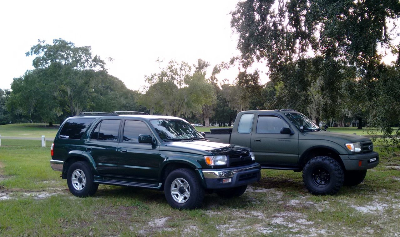

    I figure I've done enough to my T4R now that she's worthy of a build thread...or at least a thread to post pics of her so she isn't cluttering up the OGT's thread.

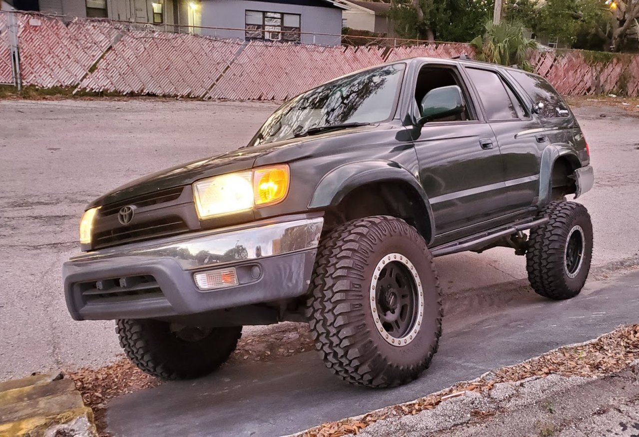

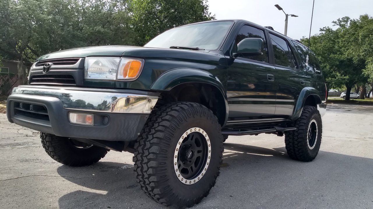

    As she sits today (5-6-2019)
    IMG_20190506_172705997_HDR.jpg IMG_20190506_172646670_HDR.jpg IMG_20190506_172736395_HDR.jpg
    Natty is a 2001 T4R 4WD SR5, 5VZ-FE, auto trans with a center locking diff T-case. She's pretty much a pavement princess, but she has earned her trail stripes.
    She was named by my mother as Natty used to be her primary vehicle before she passed away back in December of 2018. The name means Not A Tacoma Thank You. :rofl:

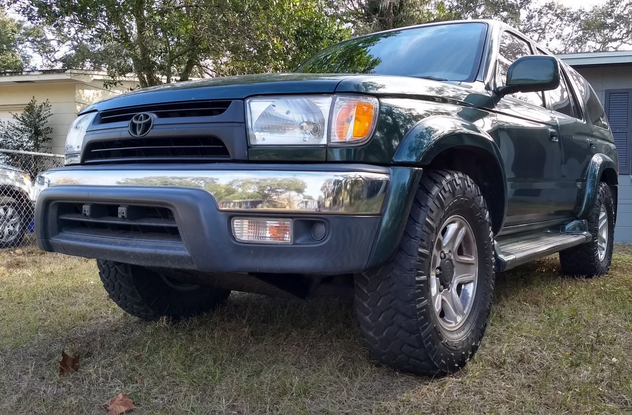

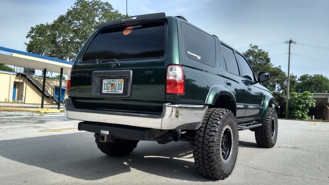

    When she joined the family...
    On 265/75R16 Nitto Trail Graps...

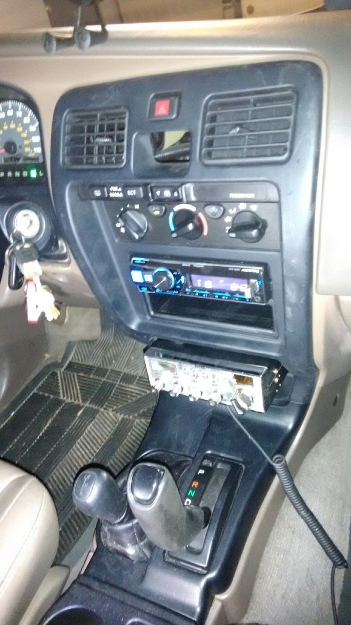

    CB and Alpine...

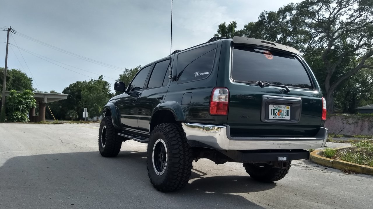

    In the process of getting her 33s...
    @Timbo's Customs rock sliders...

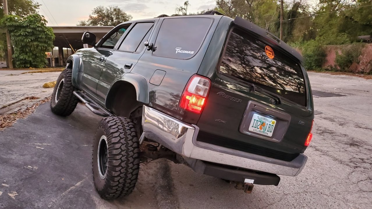

    She doesn't have the clearance to fully stuff the 33s on either end. I'm probably going to have to do a lot of trimming on the rear bumper, fender flares, and maybe some sheetmetal too, to get her to properly stuff the rear tires. I did a little sheet metal trimming and massaging with a BFH on the pinch weld to give the fronts more space, but they still won't clear at full bump unless they are pretty much straight. I'll be relying on the front sway bar to limit the articulation if I need to hit the trails with her.
    She really makes me wish I had gotten a 3rd Gen T4R to build as a trail rig instead of a Taco (or at least a Taco with an auto trans), but I've got too much time and money in the OGT to start over with a T4R.

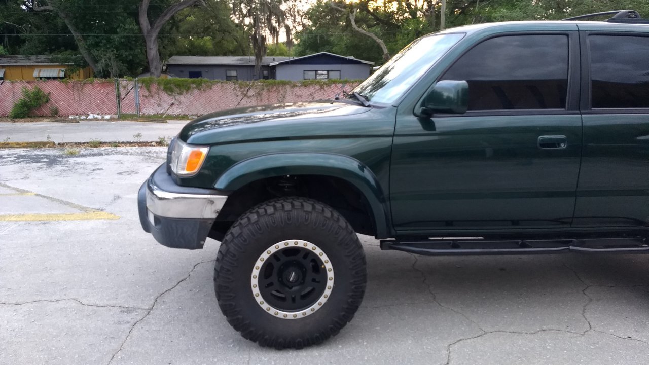

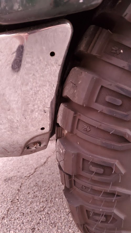

    Nothing really new. Just flexing her out a little with the 33x12.50s...
    Cw64Sl0lIBy0uF4gl-y2-n89_2DT-TbK0oY-7LbW_3f746485a9126f505734ae7530e2fa1e23638645.jpg
    vnVeA9q_OGVzz5ntdrojTF9ySioeeOBhkzRsFH_o_1feaaac5058fef21bdb8bff68aba0919aab2f76d.jpg
    Still have about an inch or so of up travel, I think, although it could be sitting on the other bump stop. I cold only see the one in the coil. It didn't rub up or down though.

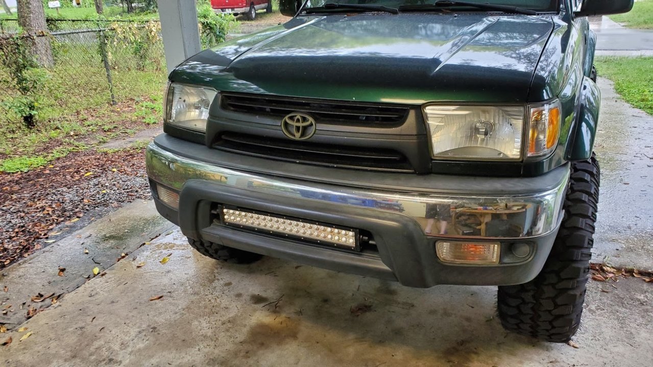

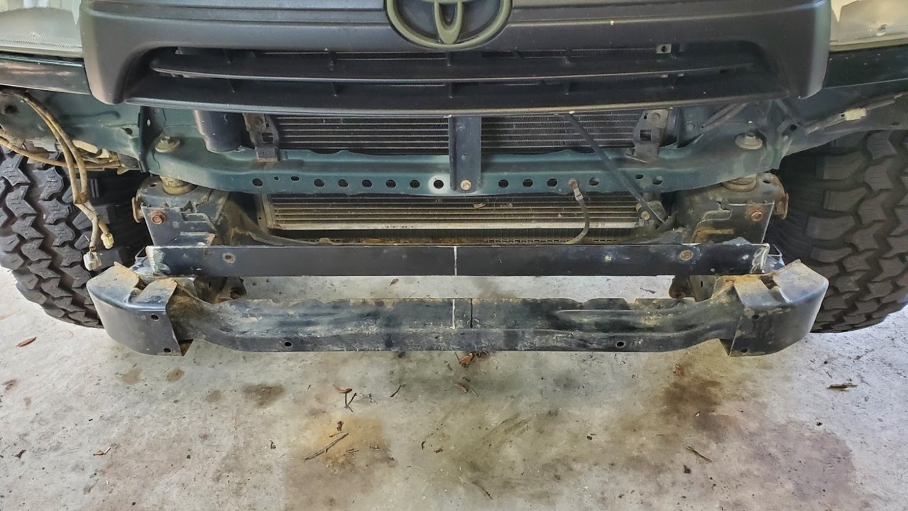

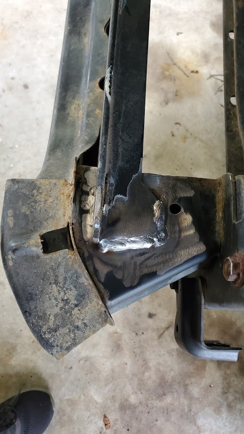

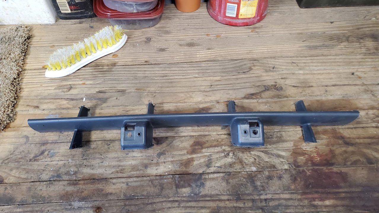

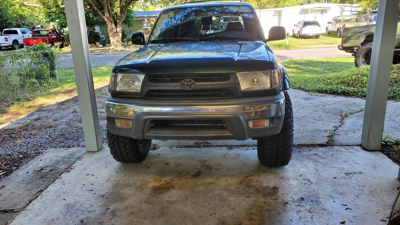

    You know, I gotta just love when I cut parts off the OGT and they provide a perfect solution for upgrades I want to do to Natty. For instance I've had my old 20" light bar sitting around waiting to be installed on Natty. Initially, I was trying to come up with mounting options using a piece of .125"x 1.5" flat stock I had laying around. First I was thinking about bending it up and bolting it on, but I knew it would be a little flimsy. Then it occurred to me that bolting shit on wasn't my only option anymore, so I decided I could weld it on at the top and bottom of the crash bar. Then I took the bumper off to really start planning and it hit me, there were two dead flat surfaces on either side of the crash bar, so I whipped out the center section of the OGT's bumper that the light bar used to be mounted to before I cut it out to clear the winch and it was a perfect fit. So here it is and I didn't so much as have to drill a hole...yet. I still have to do the wiring and install the switch, which fills me with an unfathomable joy...almost the same joy you feel when someone is about to smash your but toe with a 3 lb sledge, but, non the less...
    2yZqjJumiwUYuDY_7gjYcIl0yqR6WLn7v8cTU6N-_ac102b2177f1ba0b7d163a17cc9988c66f599ec9.jpg
    9iM54OrY6ClECxhHKnAFv4aLIMXsyMNYqpQi-UBf_02c73b9044cd4f4694f2756511943c4314ffe8ad.jpg
    Not @allenfab class welds, but I think I'm improving. The other side didn't come out as well because I think the wind was blowing my shielding gas away, but it'll hold for a light bar mount.

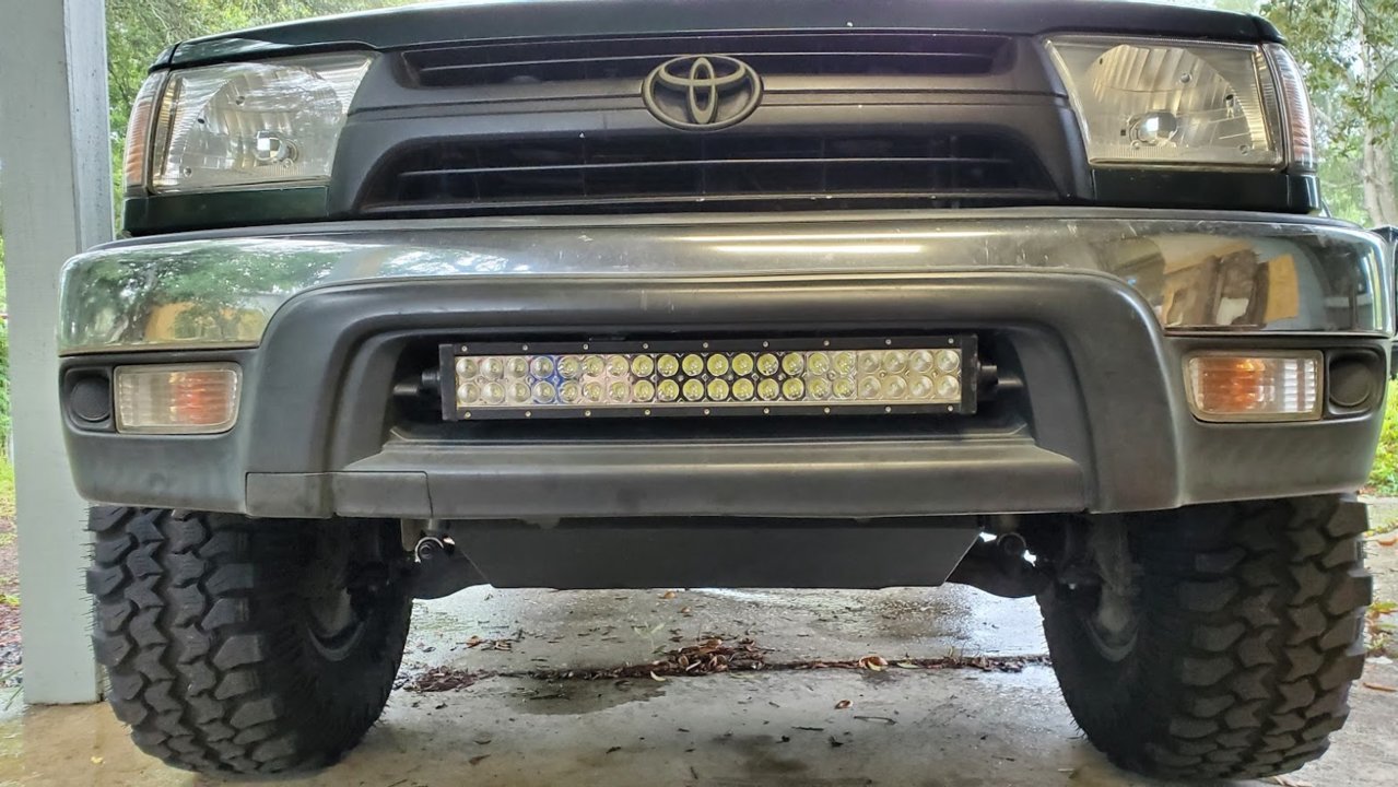

    OuGMLC6NC8FAnAi44Qca5Yk76BopcfAJIeMcplKq_8c58039449569160ad5667a11391c5987b99d5bb.jpg
    It ended up sitting a little higher than i planned, but I may at some point take the bumper off to paint it and if I'm feeling froggy, I might slot the holes so the light bar mounts align with the cut ends of the bumper grille. For now I'm leaving well enough alone. Also in this pic you can see my @allenfab front skid. :thumbsup:
    D-781UUffZlbGPS42YaJ-4CyuoVaFJNq3Uy05OQH_4683d3f5c946a40a52fffc62d50addb9ef1bd043.jpg

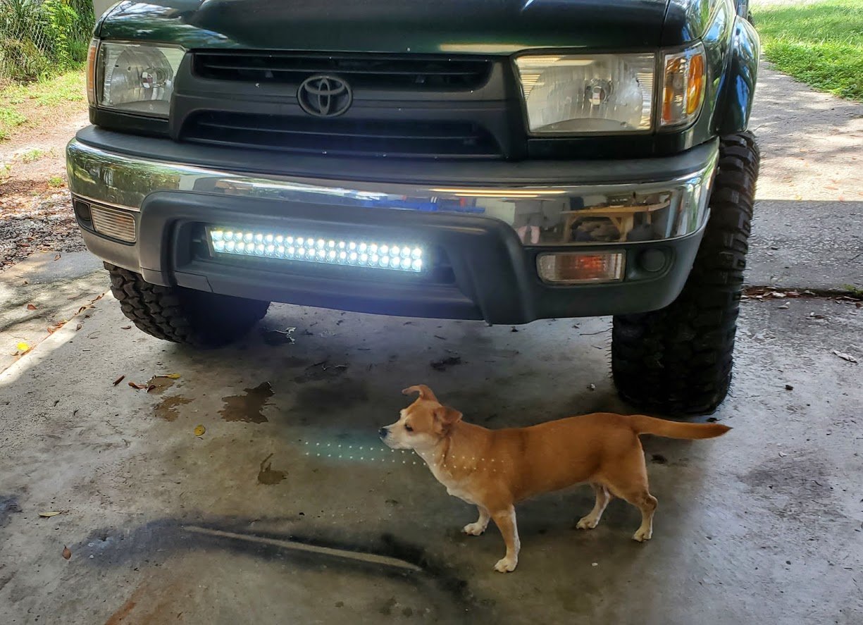

    Job Complete...Gawd, I hate wiring. It's definitely one of those things I'll only do for myself unless someone offers me an obscene amount of cash to do it for them.
    I8XgZgofJx5Or4FRaosdnSyFP7oogU7a-y7v-oTi_9ef24cccece4bb0a274e44121d23174bbcc0650f.jpg
