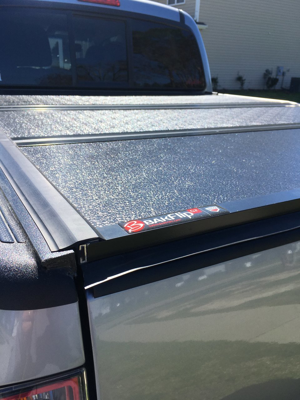

    Ok so if you guys are anything like me, you need more than one review to make you sold on a product. So here is mine:
    Exhibit A
    First off, let me say that when it comes to tri-fold tonneau covers, they all leak. So when it came to buying my Bak, I had to weigh all options. Plus I had to see which was easiest to "water proof".
    If you've decided to buy the Bak-flip G2, I recommend messaging @eccracer104 who can get you a killer discount on this cover from www.autoanything.com
    So when looking for a cover you have to first know that water will enter through the tailgate. Where the tailgate opens, water will come through. I ended up having my wife close me in the bed so I could see any light that would shine through after I "water proofed" my cover. Well, i ends up that, depending on your location, if it "Forrest Gump Sideways rains" then yes lost of water will get in. But for the normal hard rain "straight down" it will get just a tad bit of water.
    Exhibit B
    Exhibit C
    So you will notice in exhibit b where I took black silicone and ran a bead along the corners. (It's covered in sand right now due to wind but washes off) I forgot who it was that I read their review to do this but it works. I basically filled the hole as much as possible with silicone. Then I smoothed it out with my finger.
    In exhibit c, I ran a bead of black silicone along the entire edge because of the uneven side caps on the Tacoma. So people have put it underneath but I chose not to because...well I forgot to once I ran the bead on the outside. I can tell you that since doing this, my bed stays dry. IMG_4231.jpg
    Exhibit D
    As you can see in exhibit d, I get just a little water in the bed. I can tell you that yesterday we had bad thunderstorms. After it was over I ran to my truck to check it out and I was pleased to find that it was barely wet. There was only a small amount of water in the front of the bed where the drain holes are. Note: I don't have a lift or level on my truck so I have normal rake in the back. This helps keep the water (what little gets in) in the forward part of the bed.
    Exhibit E
    Now as you can see in exhibit d and e, I chose to use the factory drain tubes. What I ended up doing was using a 3/8" x 1/4" brass fitting $5 at Home Depot. Then I used black silicone to seal it up. This allowed me to use the pre drilled drain holes that come factory on the truck. I have seen other members use different techniques, but I decided with this one for my particular application.
    Exhibit F
    So this is where I'm currently at. Other tonneau covers have locks on them. This one doesn't. It is HIGHLY recommended that you get a pop n lock handle if you're looking for security of your belongings in the bed. The only flaw I have found with the Bak design is that I used a wire coat hanger to open this cover while it was closed. I'm looking to get a thin piece of angle iron (I'm open to suggestions) and screw this in front of the unlocking cable. This will help deter anyone trying to gain entry into my truck bed. I do live by a saying, "If someone wants to get in, they'll find a way". So this is just a speed bump someone would have to encounter.
    Overall I am very well pleased with this cover, especially for the price I paid. Plus the instillation was very easy and straight forward. I do recommend watching the instillation video:
    https://www.youtube.com/watch?v=HLXIeKImt4Y
    Take the video with a grain of salt but you will get the point when you use the instructions provided with the cover and the video.
    I hope this helps some of you that are truly trying to find the best tonneau cover.
