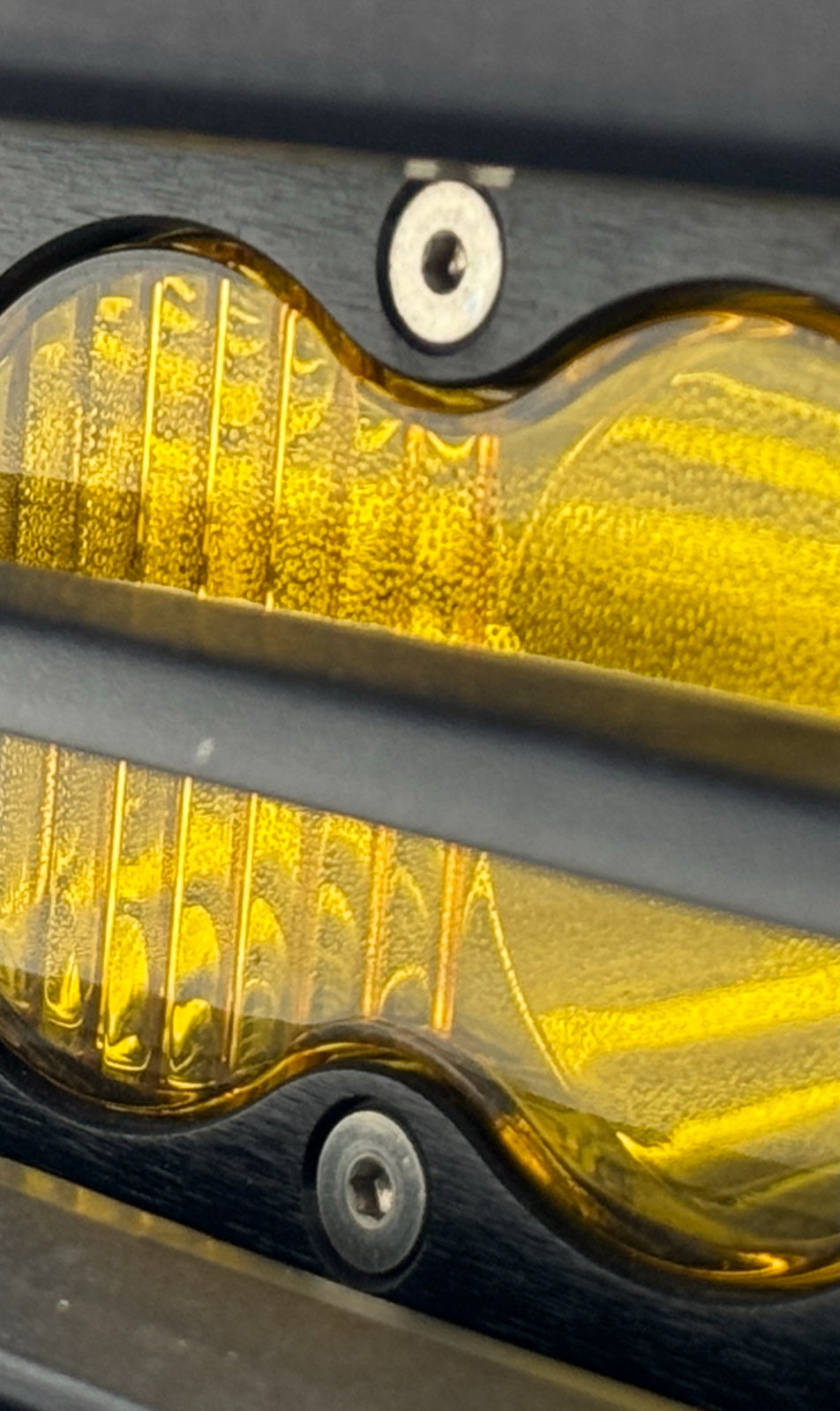

    After only 5 months & used a few times this happened today.
    Heavy condensation is visible on entire inside of lens.
    I have appointment at local shop that did clear to amber lens swap & install.
    Hopefully Baja Designs get this replaced quickly.
    Very surprised this happened so soon.

    With condensation inside the light bar, we do cover this under our lifetime warranty. While doing any lens swap you want to make sure that the O-Ring gets replaced as well as properly torqued. I will link some information below. If you have any questions or would like to get more information about our warranty please email me at bill@bajadesigns.com as I can help you out!

    I've had this happen before but didn't find it to be too big of a deal. I emailed them about it and they suggested removing the lenses to let it dry out and check the O ring. The problem persisted so I mailed the bar back to them and they got me all squared away. Shit happening is inevitable in life, but at least BD is quick to resolve. Their customer service and warranty are outstanding.
