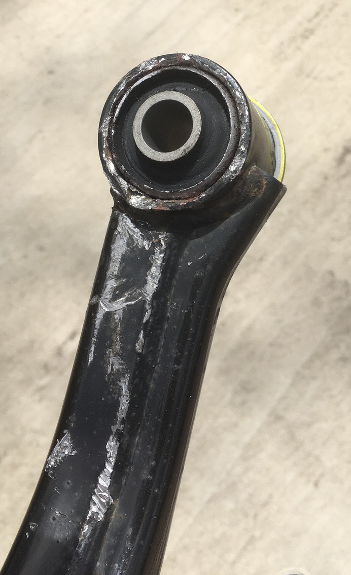

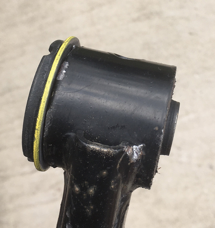

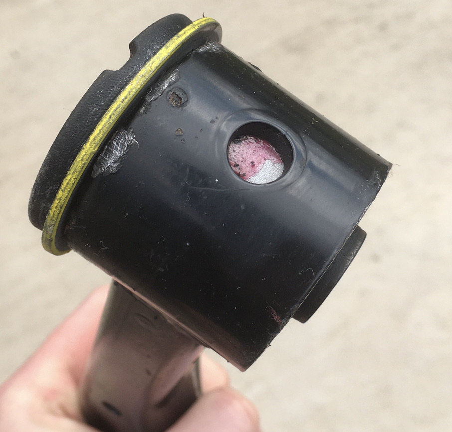

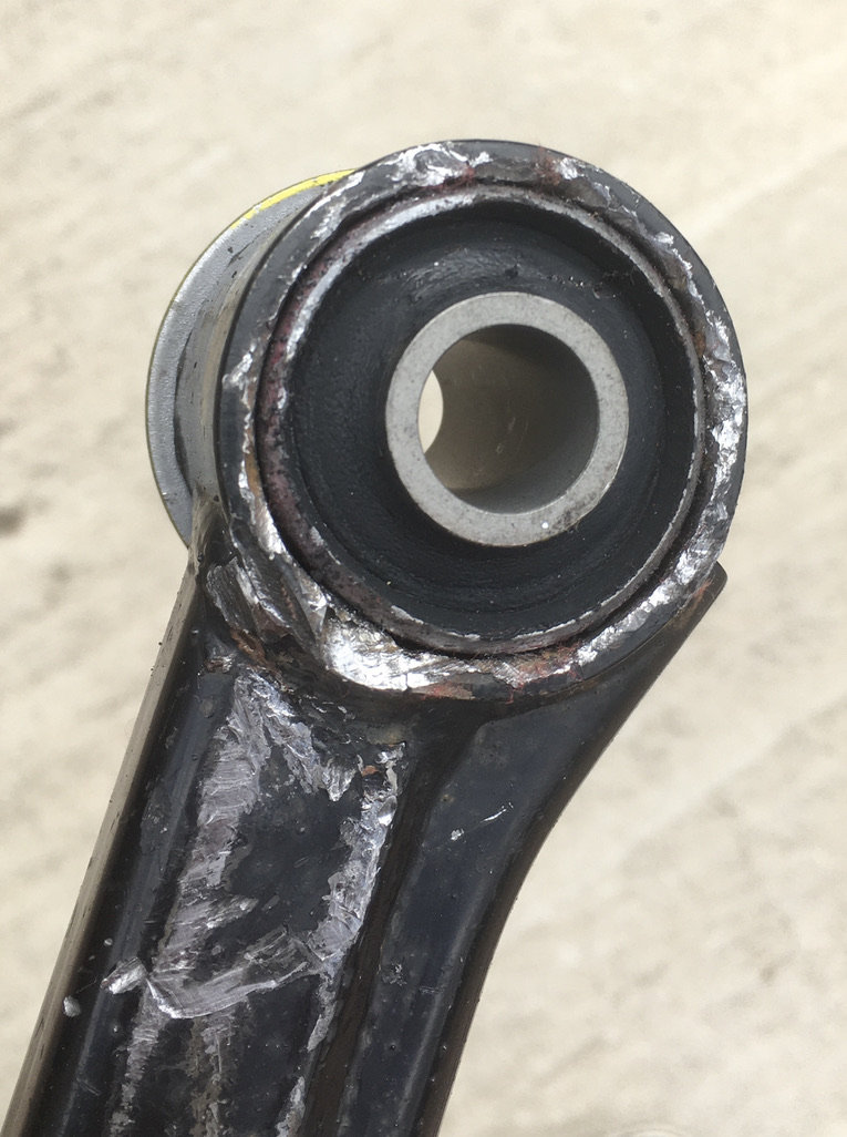

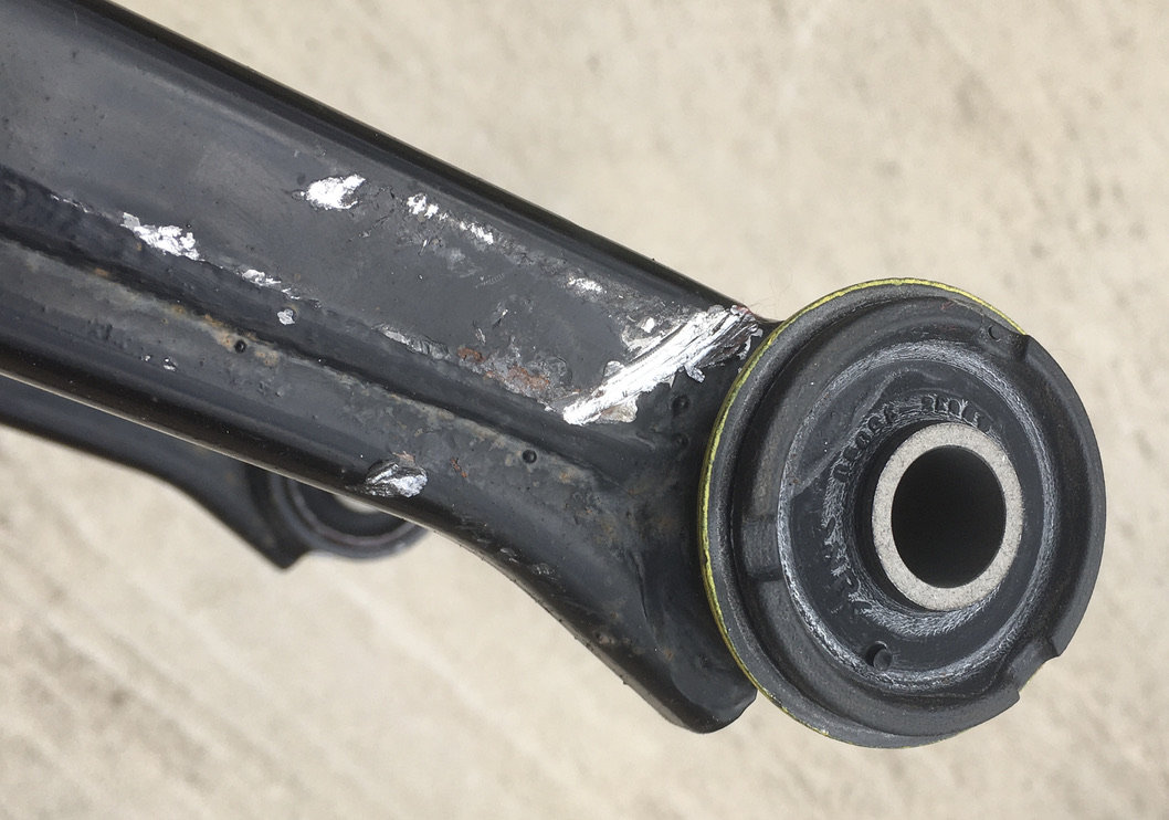

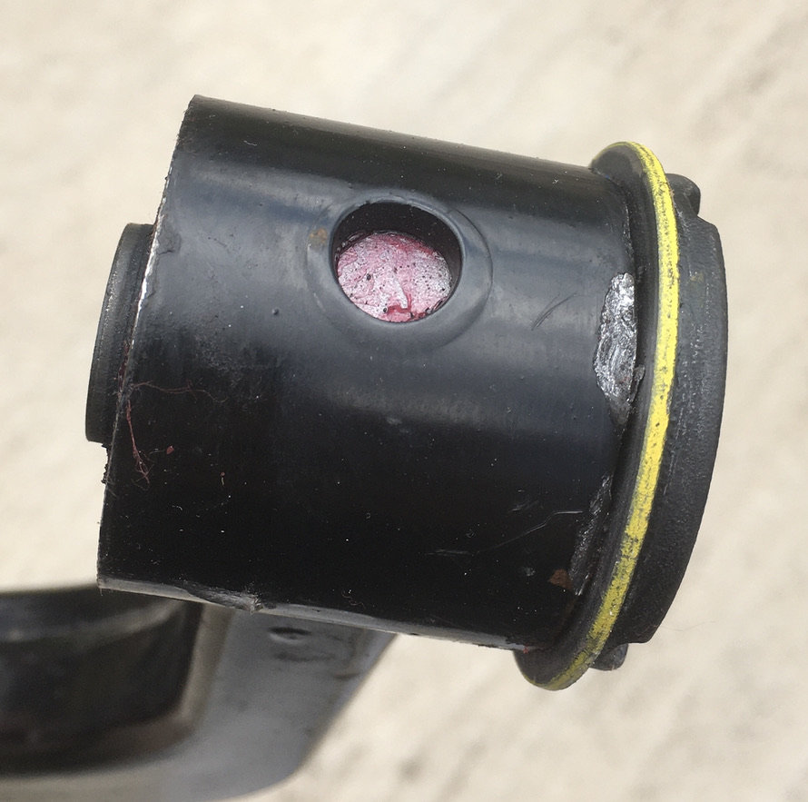

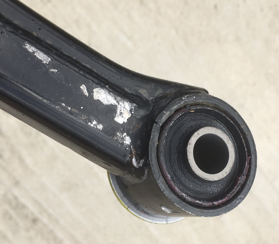

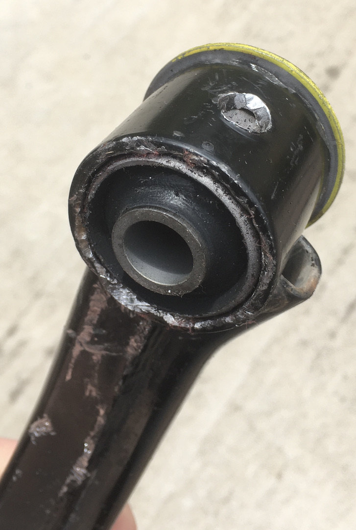

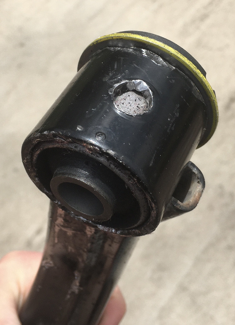

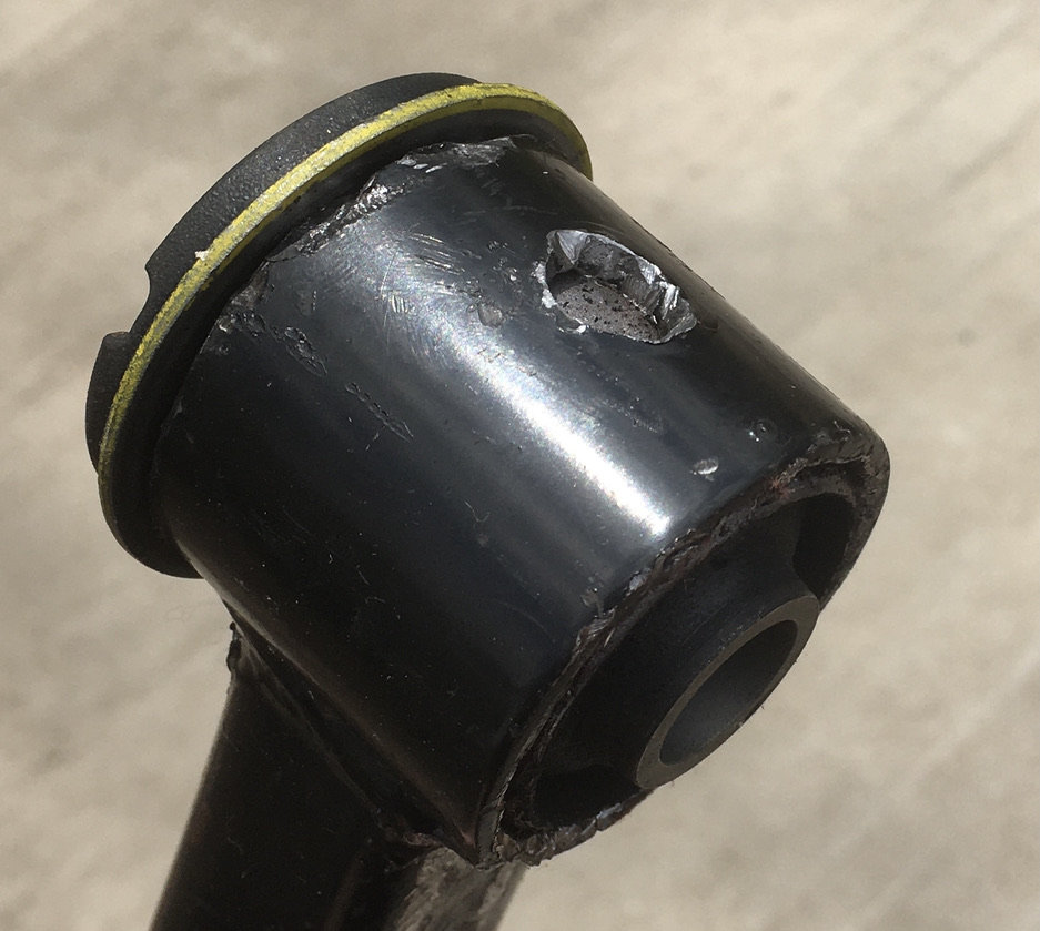

    I went to Sheldon's Auto Repair in Manitou Springs to get new bushings put into my upper control arms. I had planned to do the bushings myself--I bought new Toyota bushings and removed the arms from my truck--but found that I couldn't get the old bushings out with the tools I had. Sheldon estimated $55-90 to remove the old bushings and press the new ones in, depending on how stubborn the bushings were. That was in line with another estimate I got, but Sheldon could get the work done sooner.
    Sheldon ended up charging me $75. He returned the arms to me with some significant marring, gouging, and deformation. He didn't mention the damage, and I was in too much of a rush to notice it until later that evening.
    I don't have any "before" pictures of the arms, but they were clean and in excellent condition. You can see the "after" pictures below.
    I went back to the shop today (Monday; I picked the arms up on Friday) and told him I was unhappy with the condition of the arms. He insisted that they were fine, that the damage I was pointing at was "just paint", and that I was just trying to get a freebie.
    He eventually offered to refund the $75, which I accepted.
    I believe he should have replaced the arms, but he didn't see a problem with the work and he wasn't interested in keeping me as a customer, so it seemed like a waste of time to push for anything more than the refund.

    Dang, he did a number on those UCAs. Glad you at least got the $75 back. Where in Manitou is the shop?

    Scratches and Whatnot
    that's some bush-league shit right there. Sorry for your loss.

    It sucks that he didn't do a better job.
    That said I'd touch up the paint, put em on the truck, and move on. I don't see any critical damage.

    Also, $75 seems like alot to refresh UCAs? couldnt you have bought OE replacements for the same cost?

    I hear that, and I know plenty of others will agree with you. I don't want these under my truck whether they're safe or not. I found a set of take-offs from another TW member that I plan to pick up tomorrow.
    If you're getting a pair of new Toyota UCAs for $75, please DM me your source... that's the price one of the local u-pick salvage yards would charge :)
    The OE bushings alone cost me about $160 from the local dealer. New OE arms (pre-loaded with
    new bushings) would be about $400. You could find them a bit cheaper depending on where you buy--I paid something like 7% sales tax here.
    Moog/Delphi/AcDelco parts from RockAuto run about $70-$100/side before tax and shipping, but I wanted OE parts.

    looks like just paint
    didn't know these were going to be worn on a female celebrity's necklace at an awards show
    not really
    new arms can be had for $30 but you do what you want

    Those are some pretty unprofessional results, but personally I'd be okay running those in my truck with some fresh paint. I haven't heard of fatigue cracking around the control arm bushings... at least not on second gens (?) Heck, I've put similar gashes into mine just trying to hammer and pry-bar them back into position on the truck.
    I'm not suggesting this is a great outcome, just trying to cheer you up. At least you got the refund--as a first time customer you can't expect much more without going to court. If I took this job to a random shop in my area they'd probably charge $100 and tell me to pound sand if I didn't like it.
