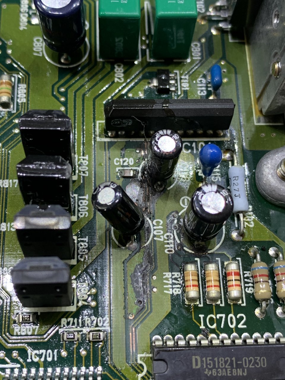

    D6D425D8-15F5-47AD-93DE-32C61C7581A6.jpg 29D05712-0FE7-4B64-AA93-52D1001EDFBA.jpg Hi everyone,

    Finally I took the ECU out and found some black lines under some caps like the lines are burned also the scanners don’t link to the ECU on ODB port so I am assuming the ECU is bad. What do you think?

    Ouch. That board looks to me like ike a trace burned up due to a short. Maybe repairable with a schematic and some creative soldering, but you're better off with another one.
    You might be able to find the right used one through car-part.com, but first you'll need to check all the connections to the ECU to make sure nothing is shorted first. They don't burn up like that all by themselves, so there's an electrical problem elsewhere (or there was).
    Is it obvious which pin the burnt trace connects to on the connector?

    Almost looks like the electrolytic capacitors blew from the residue.

    That’s what I think happened, in that picture I had already cleaned it a bit to see the actual damage, looked like oil from one of the caps.
    I have to check if those lines go out to the plugs I didn’t think of that.

    This trace burned up. I think the residue you're seeing is conformal coating.

    The small capacitor leaked out, and its actually in the area that controls the fuel injectors I am assuming as there is 4 big identical transistors in that location.

    I have exactly the same bad capacitor as you. ECU cannot be read by OBD reader. I have the ECU repair where all the capacitors are replaced but it still will not work. My 97 Tacoma ECU is 89661-04250. Flagship1 wants $772 for that ECU which is quite a gamble because it might not work too.

    A company I worked for had a few oscilloscopes fail because of a problem with the electrolytic capacitors.
    Capacitor plague - Wikipedia
    My truck runs fine now, but after seeing this, I may replace the caps before a problem arises.

    I went ahead and recapped my ECU even thou there were no signs of leakage. I used the capacitors suggested in the 1st post of the clublexus forum. Reading through the clublexus thread and watching the Car Care Nut video made me take the risk.
    The result has been mostly positive. My truck before the recap would get 15-16 MPG going from home to Barstow, Ca. The route starts at sea level, climbs a few 7000ft passes and ends at about 2500ft elevation. This weekend, after the recap, the MPG was 17 going to Barstow, and 18 going home. Another positive is the low RPM, high load ping I have had since installing the S/C is gone. Before the recap I tried tuning that ping with the URD 7th injector several times. Never could get rid of the last bits of ping. Also the throttle response at freeway cruise seems better.
    The big negative was the removal of the old capacitors. The ECU solder was sticky and seemed to have a high melt temperature. There were two capacitors that had large ground plane pads that were acted like heat sinks. It took too much heat and time to release the caps. Two of the support pads (not the pads that had electrical connections) delaminated and came off. As a fix I blobbed solder on the cap leads that were missing the support pads. Also hot glued the caps to the PCB for extra support. Because of this damage I may have created a latent failure and would not try recapping again.
    I would consider a professional outfit with better equipment and technique. My typical offroad trip is 300 to 400 miles total, 250 miles are freeway. A solid 2-3 MPG increase is at least a $10 savings in gas per trip. A recap may pay for itself. I have a 2005 Matrix that idles rough, and MPG has dropped. Maybe I get some quotes.

    How’s it going everyone just wanted to update. I had a problem with my 1997 2rz 2wd Tacoma ECM I took mine apart and cleaned the burnt areas under the capacitors with alcohol and it worked fine no problems until today. It gave me the same issues Ecm won’t connect and will run rich and sputter. During the time I had the first encounter with this problem I looked high and wide for a replacement Ecm for a 97 Tacoma part no. 89661-04240 and couldn’t find the exact part number so I bought a 96 Tacoma Ecm hoping it would fix the problem if it ever came up again and stored it away. Installed it today and it runs top shape! No problems at all. So if you guys are wondering if there is another ecm you could use a 96 Tacoma 2rz will work mind you it is a manual transmission so make sure donor ecm is the same. Part no. For 96 ecm is 89661-04150 worked like a charm. Only time will tell. Will keep updated if anything should come up.

    Just wanted to add to my last reply. I believe the problem with these Ecm is humidity and moisture prior to me having this problem is I fixed my AC and it’s a must where I live 90+ degrees, I ran the AC constantly and after a few months this problem came up. After doing some research other people having this problem on rainy days maybe they run their heater cold and hot creates condensation. If you look or feel behind the glovebox where the Ecm sits there’s an air duct that runs right across in the front of the Ecm with 2 connecting points on either side, I think with these older trucks the foam seal that supposed to prevent air from leaking from the ducts get brittle and air (hot or cold) blows right into the Ecm creating moisture inside. Maybe if you seal these air ducts or somehow insulate the Ecm I think this wouldn’t be a problem. Just my 2 cents
