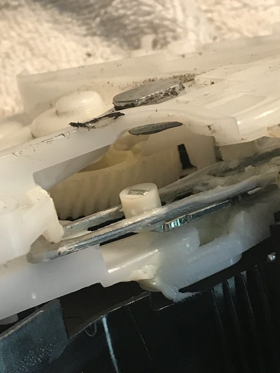

    I had the symptoms of a bad door lock actuator Motor. The FOB would occasionally unlock the drivers door but not always. I bought 4 motors last time one went out so went ahead and put a new motor on thinking it would fix the issue. It is still very not working properly.
    I also noticed that when I push the unlock on the FOB when it doesn’t work I hear a slight tick near the tweeter. What is strange is pushing the unlock button once should unlock both front doors which isn’t happening. 2 clicks will unlock 3 doors but may or may not unlock the drivers door.
    I have replaced the FOB’s battery.
    Any ideas what to check out next?

    Check connectors for corrosion. Probably need another lil motor replacement and when you are in there clean up all the old grease etc (TAKE PICS OF INSIDE THE UNIT ASSEMBLED BEFORE HAND!) and re-grease with some light white lithium grease.

    Coulda been a bad motor "new". The symptoms you describe have been pretty much like mine and motor replacement solved them all. But i also cleaned up dirt and debris and old grease every time i have opened one up.

    I didn’t even realize how gummed up looking it was until I went back and looked at the pics. Looks like I’ll be back in there soon. Good news is it started working again tonight when I went to the store.

    First thing I’d do is replace the fob battery. After that I’d replace the little motor and clean the inside of the actuator. The motors are cheap and as long as you take it slow and take pictures it’s not that bad. For some reason mine started working perfectly and I didn’t have to take it apart and clean it. Going on 2 weeks now. I think there is more to it though.

    I replaced both motors in the actuators and now my doors work completely fine. Be careful pulling the casing apart because there are a lot of little pieces that can get moved and it's a puzzle trying to get them all back in their proper places. It happened to me and added an hour to each door trying to get it put back together properly.
