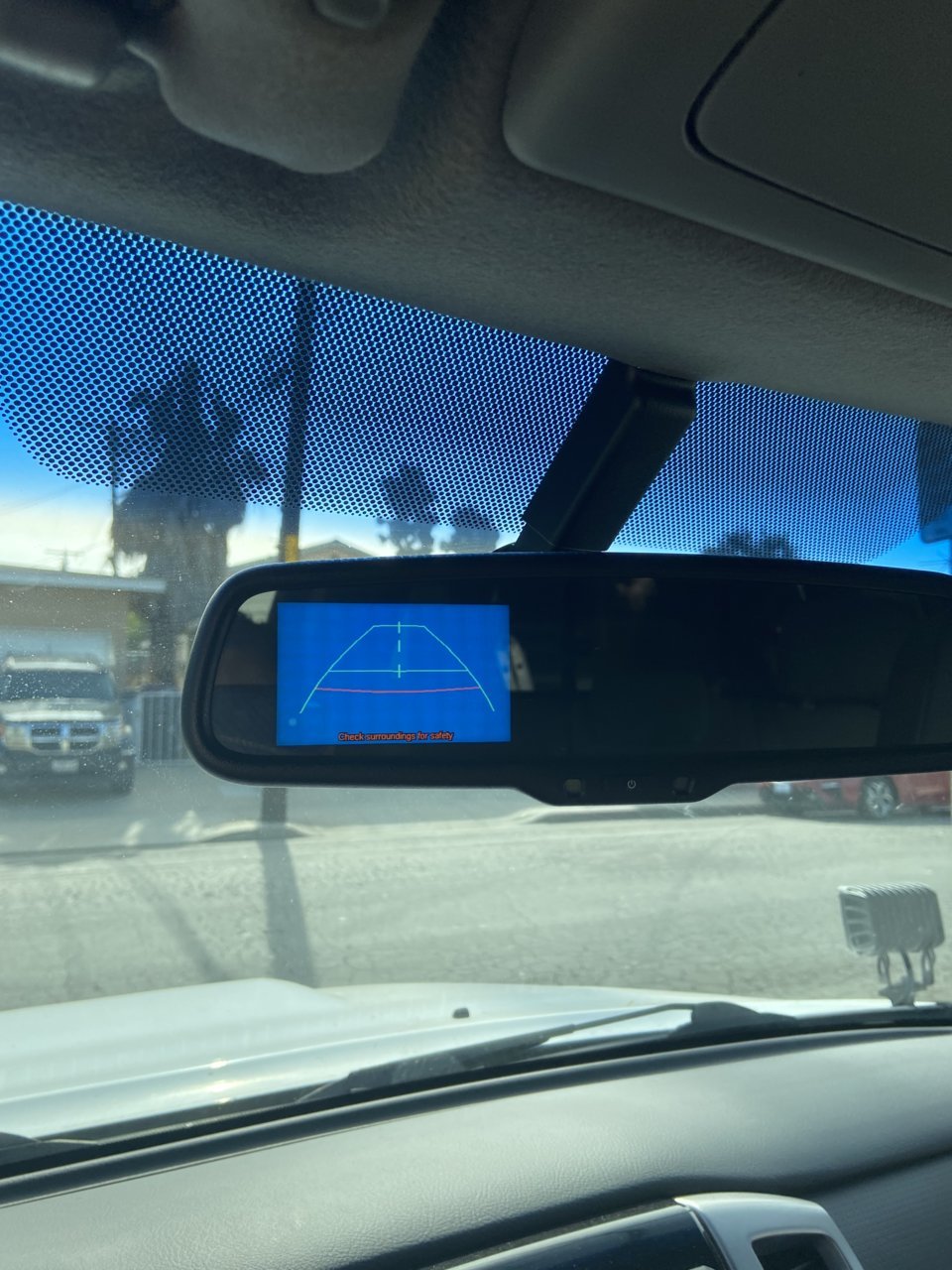

    Thought I had the blue screen death and was looking at buying a new camera. Luckily the problem was easy to spot after following the wires. Looks like the connection broke off at some point. Just needed to buy a new harness.
    Purchased part no. 82182-04011 for 2013 Tacoma
    But the conduit/taped portion to the connection came off a bit. Also noticed it’s a tight bend and can see it breaking again. It works but wondering what to do besides just tape it back up.
    Broken connection on harness
    New harness next to old
    New harness attached

    Nice to have a working backup camera again after driving for quite a while without.

    Nice work! I have the blue screen of death now.
