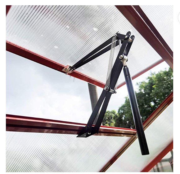

    Not so much with humidity, but the heat... yikes. We're on a week of triple digit highs, 101, 103, etc. Good thing about the location of the GH is it's shielded from full sun from noon to about 5pm by a large maple tree. In the winter the leave will be gone so it will get full sun then. I'm looking at these automatic window openers for the transom windows along the front. No power needed, opens when temps hit 75 or so. We're also planning on installing landscape shade cloth across the interior ceiling on pulleys, like roman shades, to block sun as necessary.

    I think my Dad’s setup is similar. He uses a set of similar windows on the roof and has a screen door at the entry. The solid door stays open when it’s hot, air flows in and out the roof while picking up moisture. He also has shade cloth on the roof to moderate the solar radiation. He also uses a swamp cooler and misters to keep the humidity correct. There are roof level misters which sort of create an artificial rain periodically and others at the bench level which keep the gravel floor wet. It keeps the humidity in the right range for his orchids. There is also a reverse osmosis system to keep the water soft. This is largely to keep hard water deposits off the leaves because he shows his plants.
