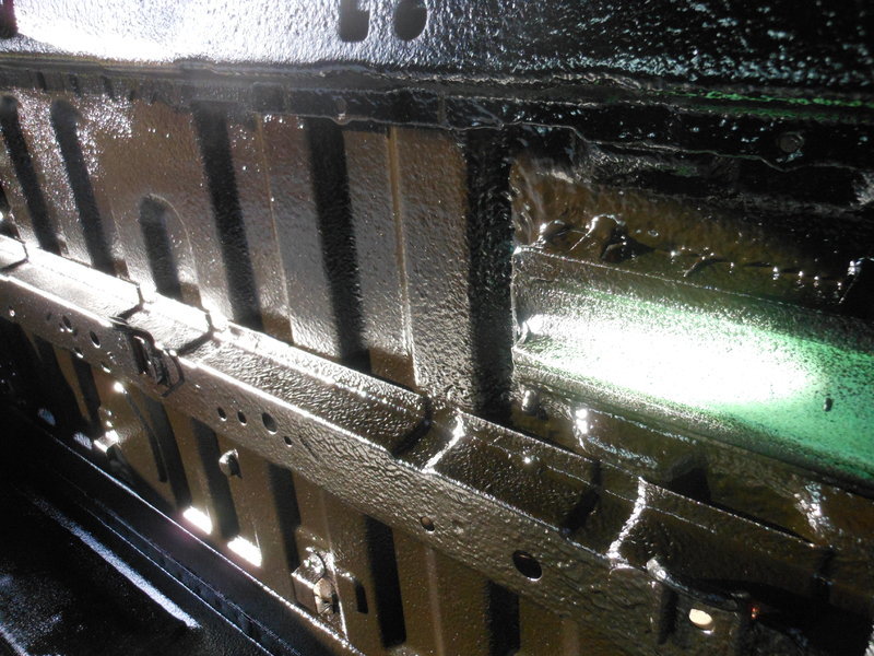

    When I sprayed my rear cab wall with sound damping stuff, I noticed how sloppy those vents were, so I sprayed the shit outta them (around them) to seal the air/water movement... worked for me...This is the "before" pic.. at least 1/4 play forward to back...
    What you are showing is really bad... Are the vents still working or missing the flaps..? Seems like a lot of water.. Just seal the f'rs and forget the dealer.... show them if you are nice... they might care.. doubtful though.

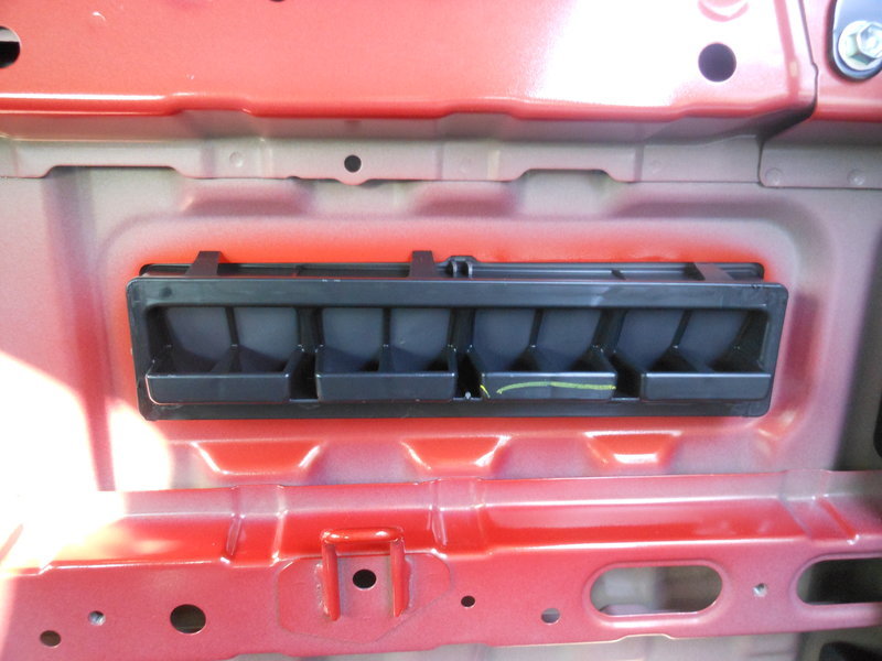

    Here is my "after" pic....
    Just have to remove the green tape and the vent are free to work as designed again...!!

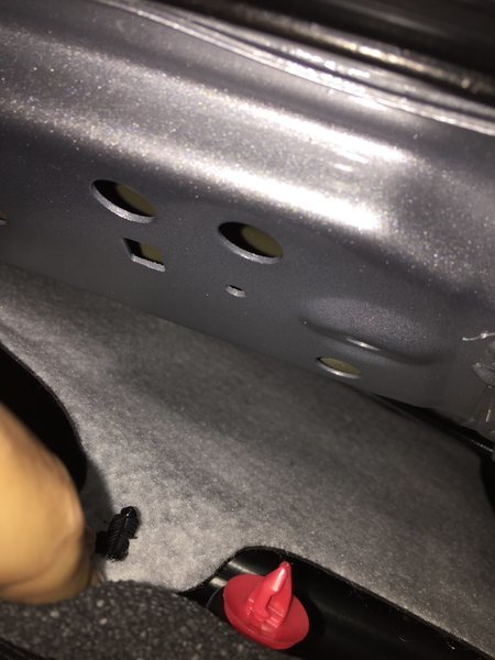

    Mine are bone dry. Just pulled the rear out and pulled the pads. This pic is crappy and shows only right above the vent but the whole pad looked dry just like this.
    One thing I notice in your pics is how much sound deadening you have right at the vent. Could that be hold it up?

    NO. it's clearly the loose, sloppy vents... but if you are in there check those loose vents and put silicone or something all around them...!! Then again... it may your rear window leaking..??
    Best advice I can give ya... FWIW.. cheers..:thumbsup:
