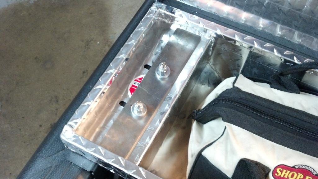

    I have a rail mounted headache rack that I got off ebay. I put this box in today. I just took the bed rails off, drilled two holes in the bottom and used J hooks to mount the box. I had to leave it out away from the rack a little so the lid can open.
    Don't know if this helps you, but here it is anyway.
    These boxes are not all that thick, so I cut some flat stock to brace where it bolts through.

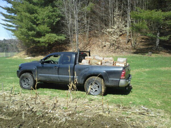

    I run a modify headache rack and tool box. I hook the tool box in with j hooks. Works great I can have an empty bed in 5 minutes to hual stuff like fire wood. uploadfromtaptalk1392306105493.jpg

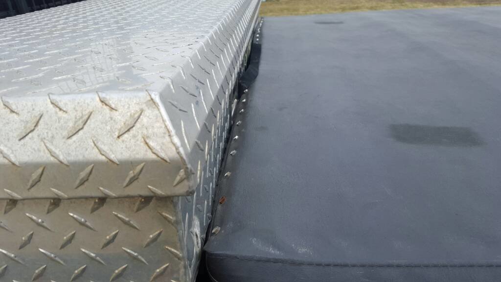

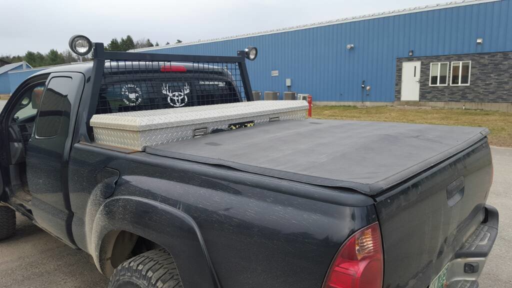

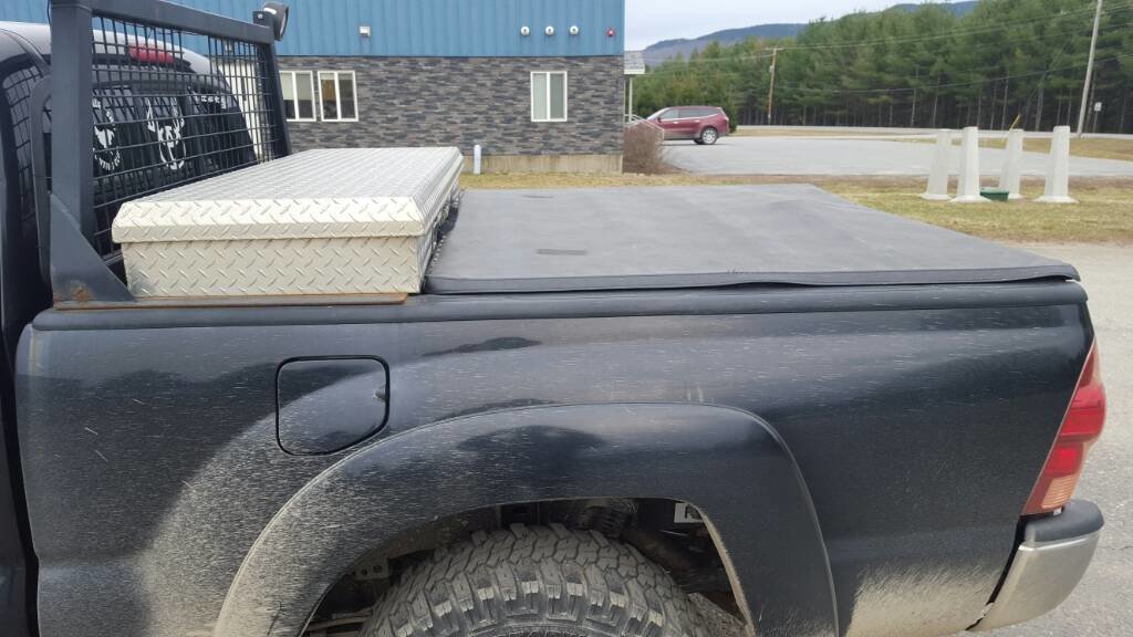

    2012 Silver Tacoma Access Cab
    Another method for the toolbox/tonneau combo, from @NorthRoad is to make a cutout in the cover and install the box through the hole.
