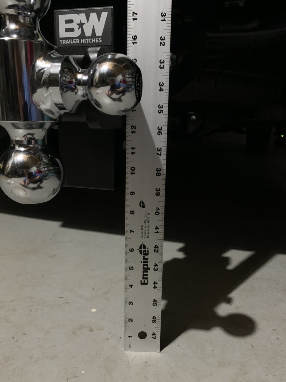

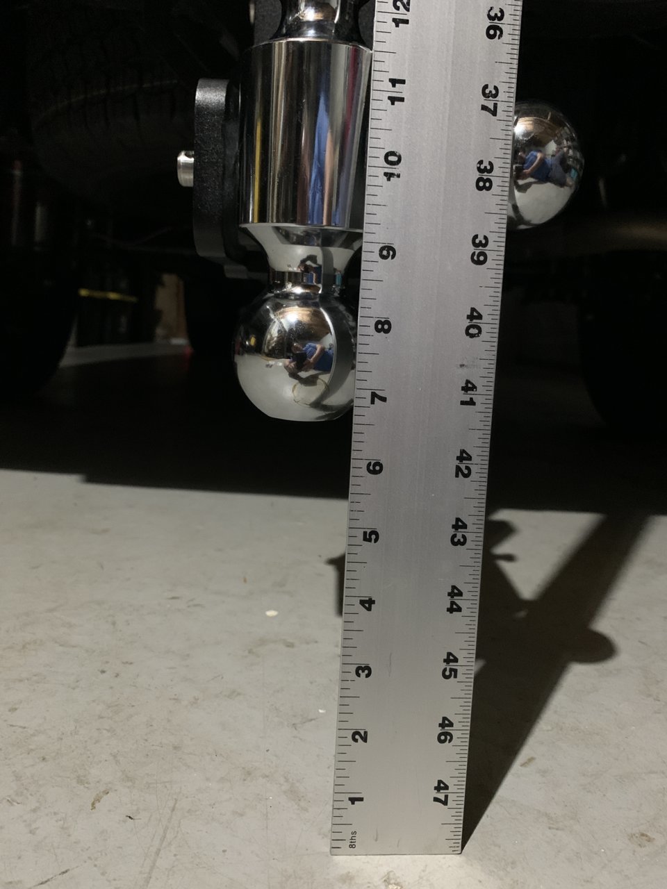

    I just bought a B&W Tow and Stow hitch and I am second guessing whether I got the right size. I bought the 3 ball version with the adjustment to 5” drop or 5.5” in rise. My truck is a stock 2020 TRD Pro. Unloaded, I have 9 inches from ground to the low point on the hitch. If I lower the ball to the lowest drop position, I have 6.5 from the ground to the low point of the lower ball. I need to tow a U Haul trailer this weekend (which I don’t have yet), so not sure what drop position I will need to level it out.
    Does anyone use this adjustable 5” drop B&W version on a stock Tacoma. Any issues? They sell a smaller version that has a 3” drop adjustment I could exchange this for. Any advice is appreciated as I have limited experience towing and with hitches.

    9” clearance unloaded from ground to bottom of the metal bracket
    6.5” clearance unloaded from ground to bottom of ball at lowest drop position

    i run a 6in drop on my 16 sport taco, i scrap a few driveways nothing to fret over. you have similar ground clearance with the lower ball as i do with the extra drop and thread and nut. tow away

    Definitely not worried about any mechanical stress from towing. Just concerned about lack of clearance from ground.
    I understand how to calculate drop and the reasons for wanting a level setup. I don’t own a trailer and will just be using U-Hauls, borrowing friends trailers, and maybe future purpose. That’s why I like the concept of this hitch because it is extremely adjustable to handle any trailer I might use.
    My only question is whether the +\- 5” version I have gives enough ground clearance or should I move to the less versatile +\- 3” model for a few extra inches of clearance.
