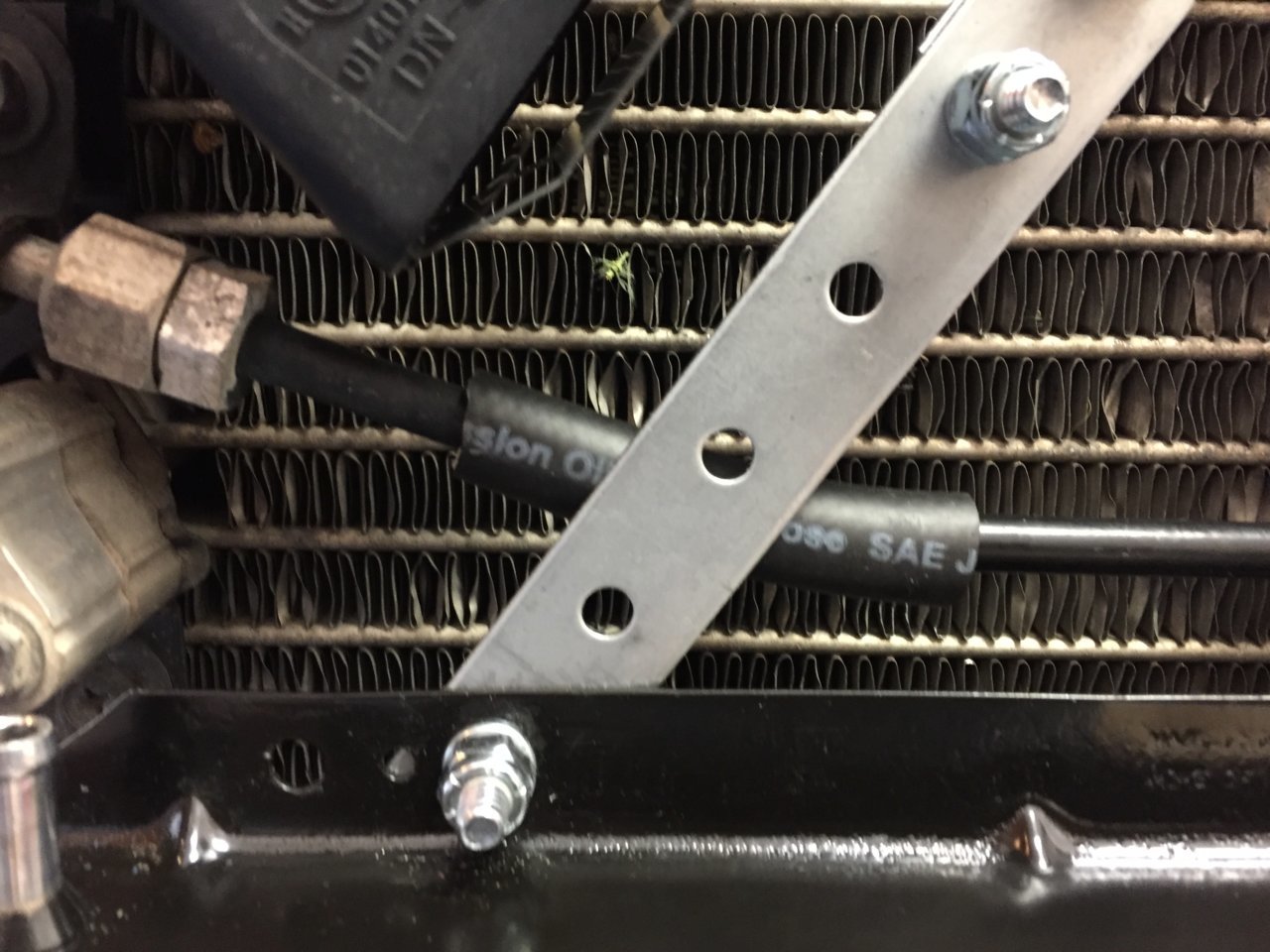

    Had to buy a second hose. The stock hose would not reach to in front of the radiator
    Trimmed the corner to avoid rub on the A/C tubing
    Cut and zip ties on hoses to avoid damage from rub
    Drilled into front clip to mount bottom

    How is this holding up for you?
    Did you completely bypass the radiator?

    link to the cooler you ordered? Looks like a double stack?

    Looks like it might be a 70264 or 70268.

    I did not bypass the radiator
    I ended up switching to one with a thermostat bypass because it was running too cold in Colorado winters
