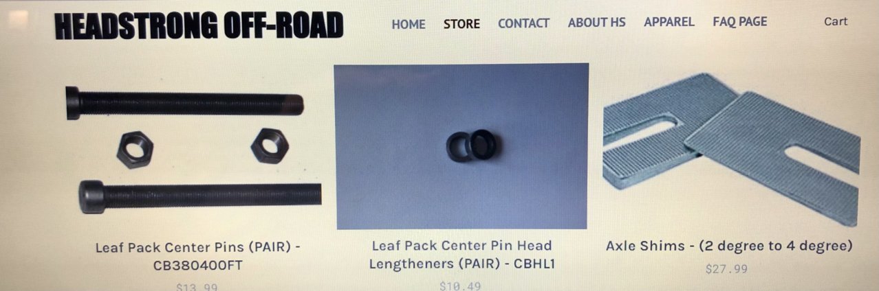

    I installed ATS Leaf Springs with 2.5”’s of lift on my ‘15 DCSB 4.0. I had take-off vibe (even before with aal) so I installed a carrier bearing drop kit + 1/4” washer and it was greatly reduced.
    I also have a slight hum between 65-75 mph which goes away when not accelerating. I don’t feel it but I can hear it. I don’t know if this can become an issue. From what I’ve read this needs to remedied at the axle, not the carrier bearing.
    So, I want to purchase center pins, pin head lengtheners and steel axle shims.
    Aluminum tends to get crushed after a while. I spoke to Toytec and Wheelers yesterday and they don’t carry them in steel.
    @Toytec Lifts
    and @HeadStrong Off-Road do carry Zinc axle shims.
    Anyone here running either of the shims pictured here? Any issues? Are the zinc ones strong enough to not get crushed over time like aluminum?
    I also like the ease of replacement with the zinc ones. Just not sure how they’ll hold up.

    I've had the zinc ones from Headstrong on for a few years now without any issues.

    I went with steel because I wanted 2 degrees. However, I really don’t think you can crush aluminum or zinc shims.

    I could be mistaken, but I would assume these are zinc-coated steel (aka galvanized) and not pure zinc, which is quite brittle.

    I thought the same but I’ve read/heard that aluminum is not recommended for this application.
    I had to look that up. Hahaha. You’re right, zinc is brittle. Hopefully they are zinc-coated steel. I’ll reach out to Headstrong today as soon as I have a moment. Thank you.

    I ordered from @HeadStrong Off-Road
    The shims are zinc-plated steel.
