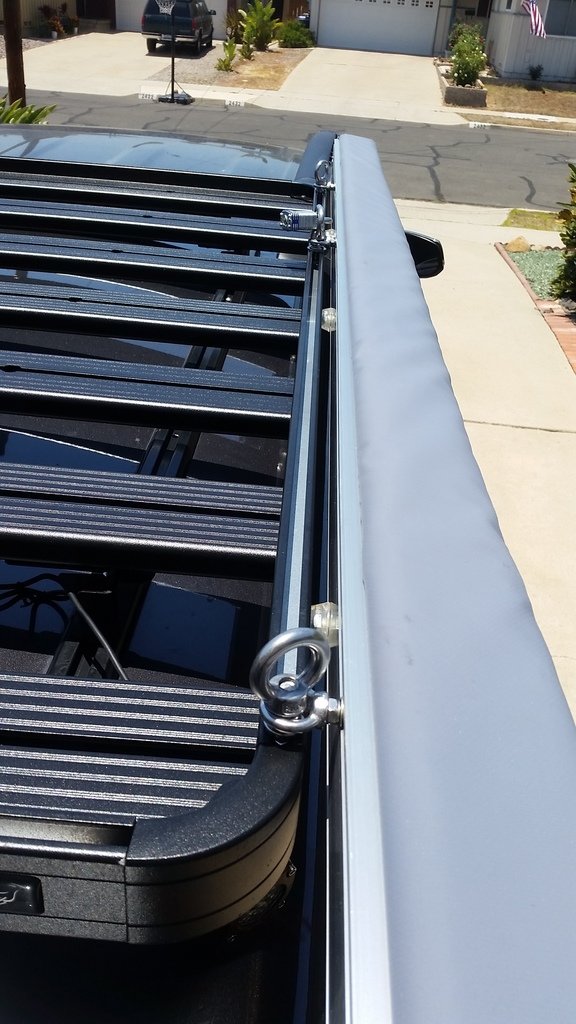

    I am 6 foot with a DCSB. Originally, I bought a DAC tailgate tent so I could sleep with the gate opened. I can only say it was not designed for the Tacoma! The distance between the raised window and the lowered gate is way too short.
    Since I have a Front Runner rack and an ARB awning (6.5' x 8') I decided to design a portable mounting system so I can easily move it from the side of the truck to the rear.
    Awning%20Mounted-side%20view_zpsjqdj4ol5_039c0a935470c29bd15a45d6a80d58d4693a80bc.jpg
    I have 3 mounting points on the side of my Front Runner rack. The top track of the awning has 6mm eye nuts that fit over the 8mm FR posts. To hold the awning in place, I secure it with 8mm eye nuts. These also provide lashing points for the rest of the rack. I am using the bottom track of the awning to hold 3 soft plastic/rubber spacers. These serve 2 purposes; to keep the awning vertical and to provide additional contact points to the rack. Note: I am also going to add one or two heavy-duty galvanized L brackets to the lower track which will rest over the FR side rail. This should take some of the stress off of the eye nuts. To ensure the awning is snug to the rack, I will lash the awning to the rack with two beefy velcro straps before traveling.
    As a theft-deterrent, I have another 8mm eye nut next to the middle post. The purpose of this one is to allow me to lock the awning to the rack.
    FR%20Awning%20Side%20Rail%20lock-closeup_8061d38b8a5bd9fdae6c10dc5a2b29ea98a11963.jpg
    To relocate the awning to the rear of the truck, simply remove the 3 8mm eye nuts and set the awning onto the 2 rear posts, then secure with 2 of the 8mm eye nuts.

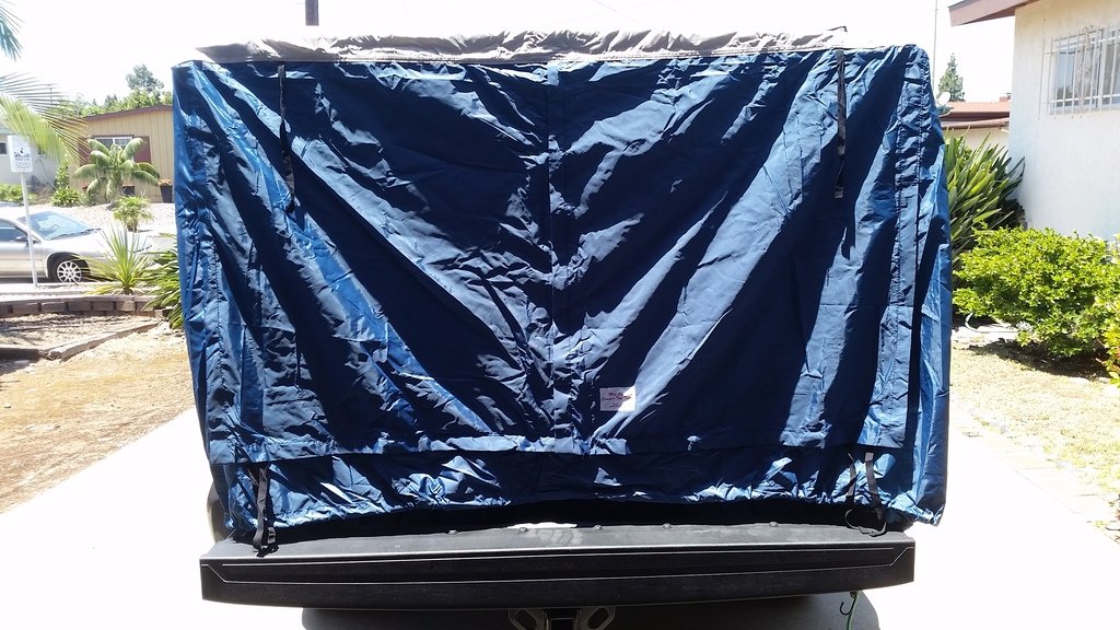

    The awning cover should keep most of the elements from blowing into the tent area from the roof.
    Awning%20Cover%20Touching%20Shell-inside_bcd5bd777c0a6a8b4483c6f0d0c8604f7ffed34a.jpg

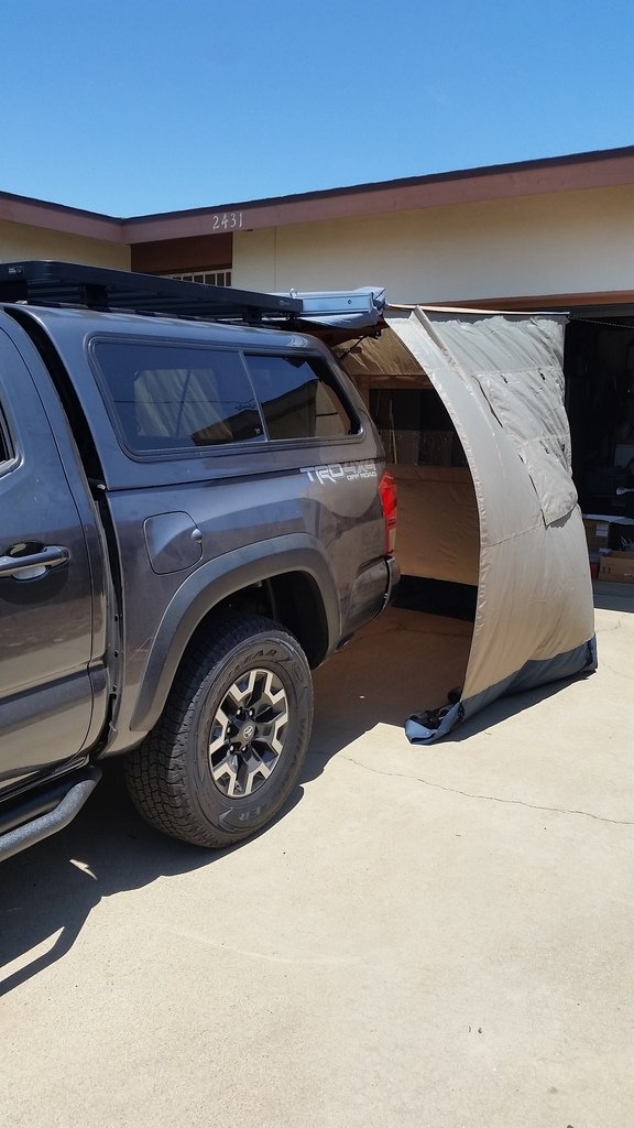

    With the ARB 3-wall set attached to the awning, I will have a bedroom and a living room! lol
    3%20Walls%20Left-Side%20view_zpspshecg9i_ec4c887562468307e3f2fbb2b34f2647c56a0aa6.jpg
    3%20Walls%20Middle-back%20view2_zpseclje_678bcab70d73f9cb6bbbf87c06fc13e53f039dcb.jpg

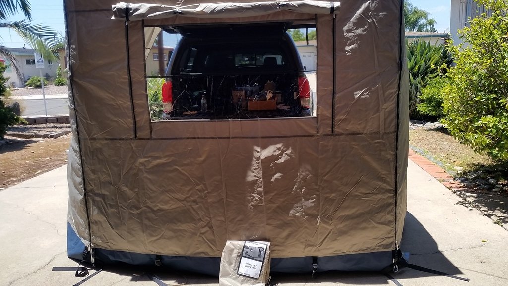

    The wind was blowing pretty good when I was testing out my concept. This panel should be touching the truck. I can see where I will need to add some velcro loops to the side panels so I can attach the sides to the truck.
    3%20Walls%20D-side%20Looking%20into%20Te_26bdb049a4280a3342d9bbe2983596743e045a6e.jpg

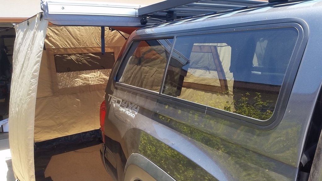

    The opening on the passenger side is large enough to use as a entrance instead of rolling up the door panel.
    3%20Walls%20P-side%20Looking%20into%20Te_63b86bcfbdc3685a92f62dcfa55355e7e6489512.jpg3%20Walls%20w-Door%20Opened_zps4azqinua_92f8db205d13f3ad06b9e2f8bd4172ea42173826.jpg
    I also have some ideas for a 4th wall that would close the air gaps around the back of the truck.
