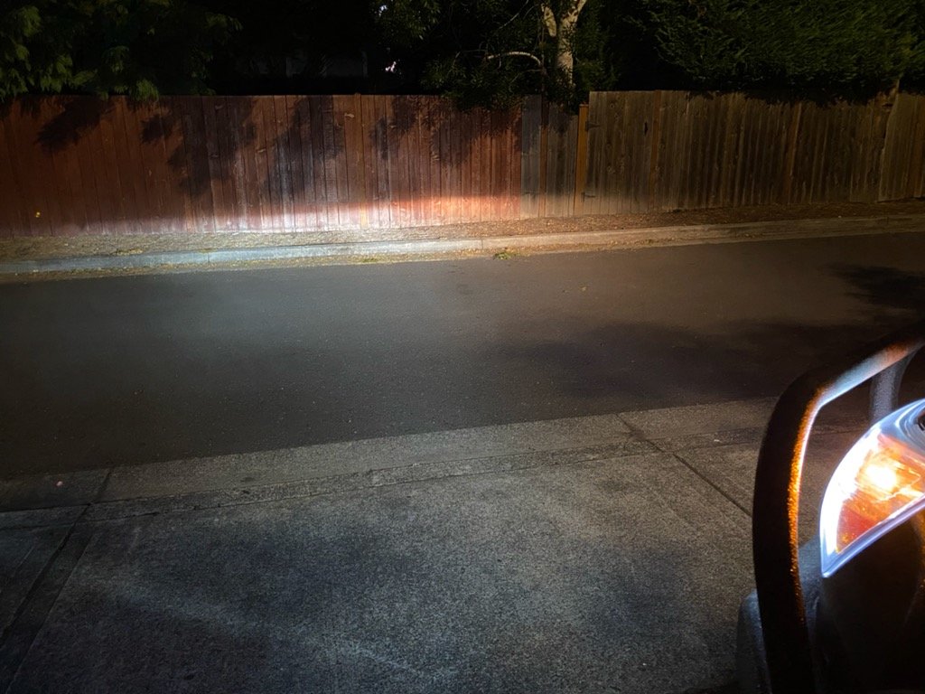

    Buddy got me some Auxito 9003/H4/HB2 headlight bulbs for my truck.
    So far they look pretty good, and it doesn't look like I will be blinding any oncoming traffic with them.
    Manufacturer claimed specs: 12,000 Lumens (200% brighter); 52 watts; 30,000 hours; IP65 rated.
    The only significant downside I can see is the 6500K color temperate for night driving in wet conditions. Which I have a lot of here in Pacific Northwest.
    Driver side: Auxito LED; Passenger Side: Stock OEM BulbIMG_8878.jpg IMG_8879.jpg

    You should return those and do the ultimate headlight upgrade, with relay and Osram 100/90w rallye H4 bulbs, given your driving environment. Significantly better performance over the stock h4/9003, notably better performance than all but a very small number of stock/near stock wattage H4/9003 performance bulbs.

    I think (guarantee) that you'll find that the actual performance doesn't come close to the published specs. That's a common problem with aftermarket LED bulbs, but people keep falling for it. As for the color temperature, you're really going to hate that with the weather you see way too often. Good luck. I'd go with the Ultimate Headlight Upgrade if I were you.
