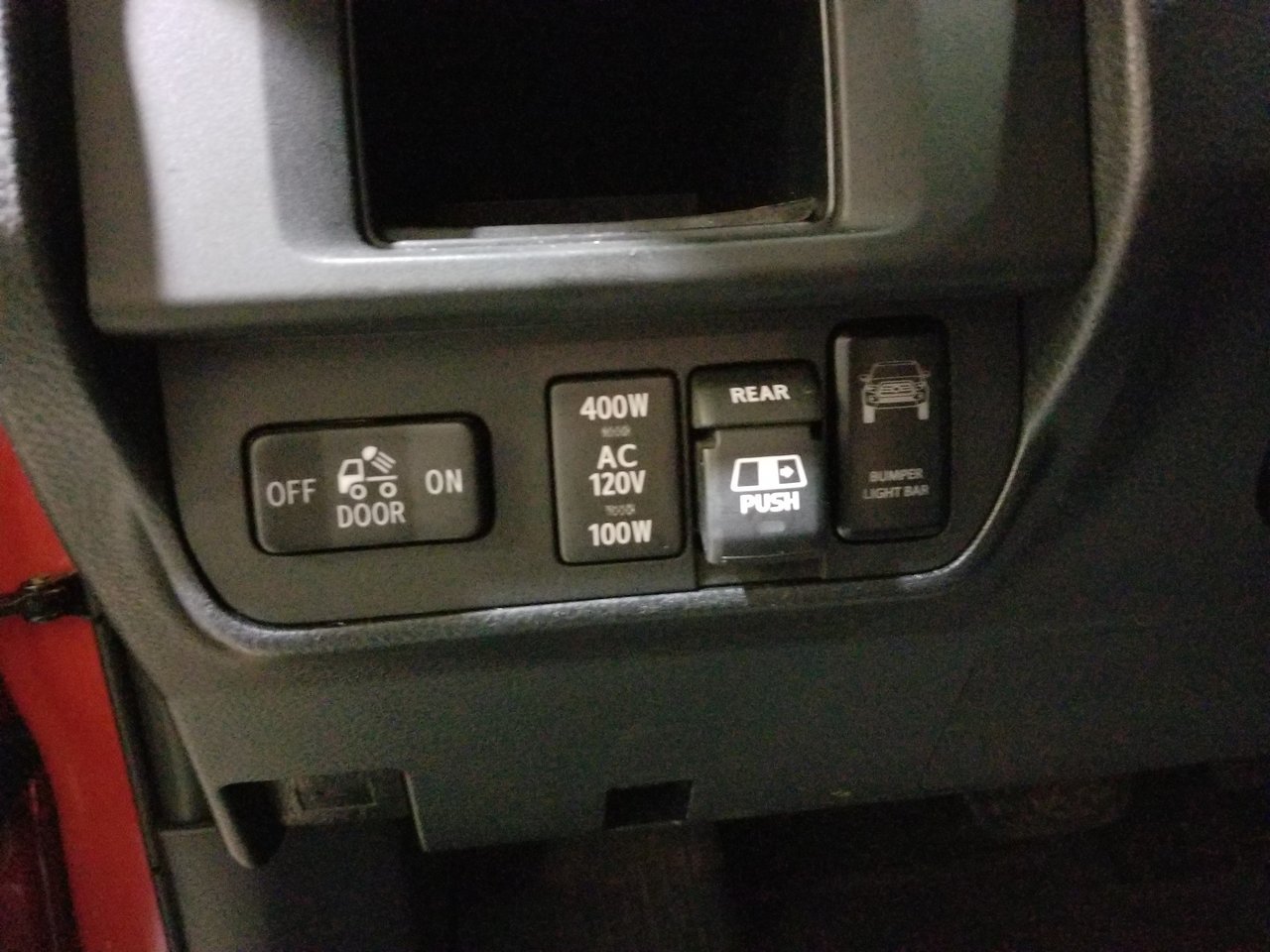

    Just finished the install of my new auxbeam 32" 5D led light bar, mounted in my bumper.
    I used the the wiring harness that was included, an OEM style switch from CH4x4 and mounting brackets from caliraisedled.
    I wired the switch into the blank location and tapped into the bed light switch so the switch only illuminates when the headlights are on (or light bar obviously).

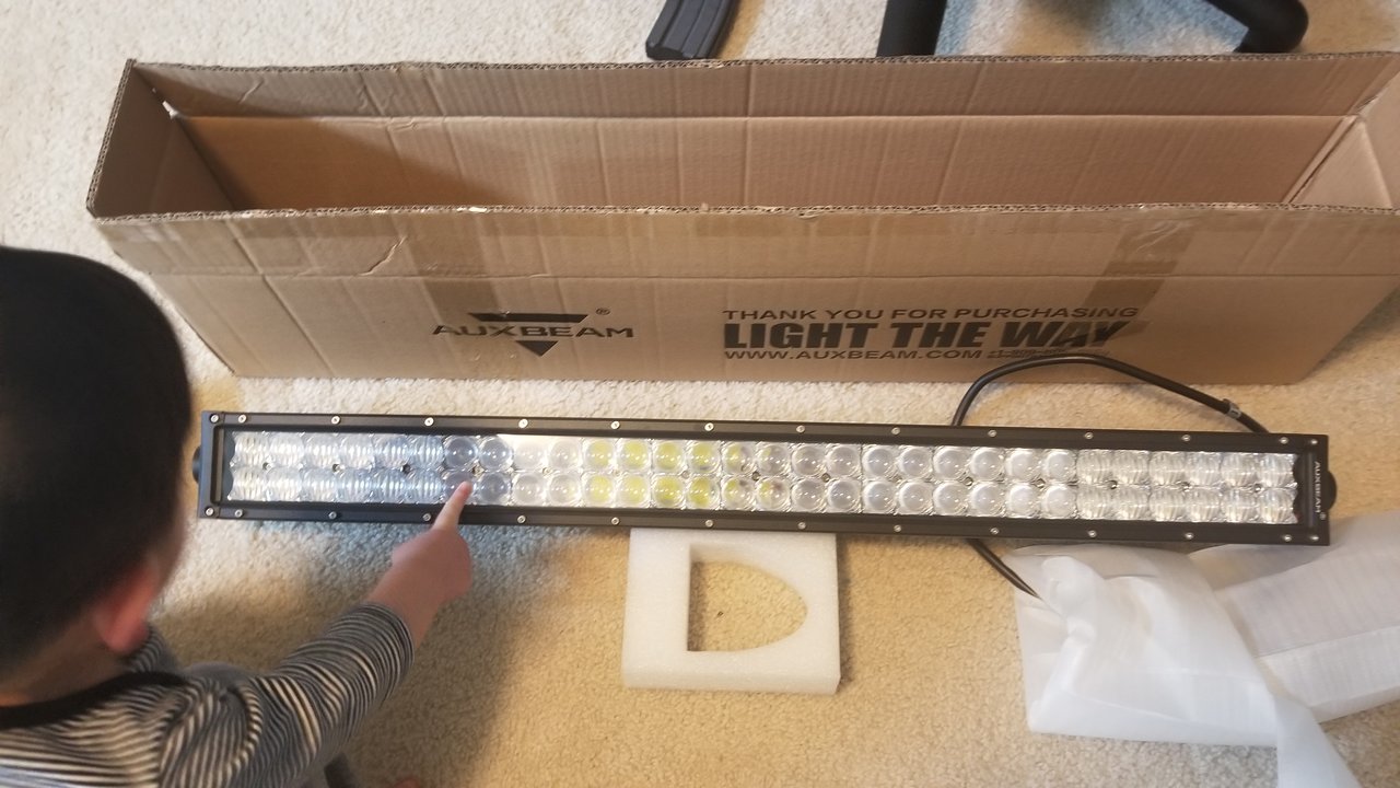

    The unit itself came well assembled with no paint chips or dents. All screws were tight and I don't expect any moisture anytime soon. Some people put silicone right away but I'll take my chances for now since it came well assembled. Here's my little helper pointing out the 5d lenses.

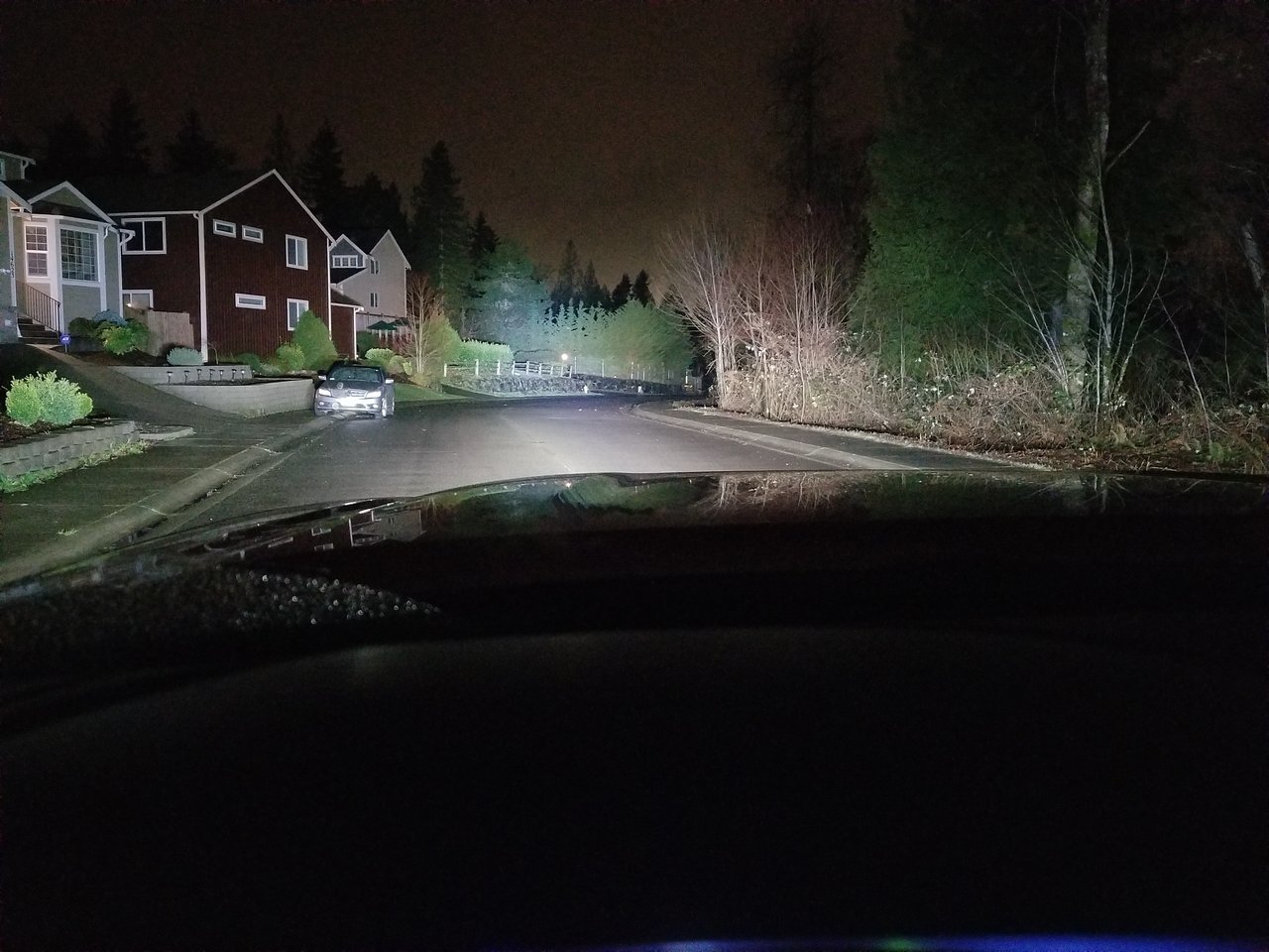

    Light output is great! The spot throws light very far and the floods do a nice job lighting up the rest. Even though it's mounted down low it lights up a lot more than the high beams and further down the road. My only complaint would be the color. I like closer to white than blue. This is closer to 6k than 5k I believe .
    All the pictures were taken on a street with no street lights and it was raining lightly.

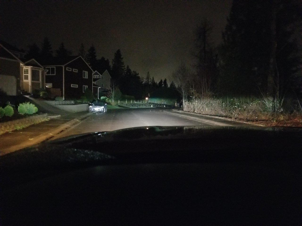

    Low beam 35W HID kit and amber halogen fog lights
    Low beam/fogs + 180W Auxbeam 32" 5D Bar
    You can see how much of the sidewalk/house and trees are lit up from the floods not to mention the throw down the street. Even the tree in the background in the middle has light on it as well. Pretty impressive for a cheap light bar.

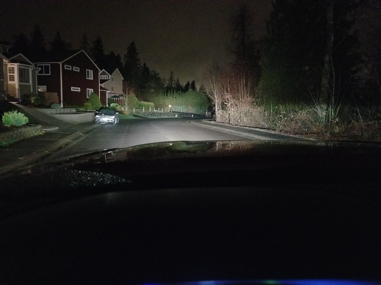

    Low beam/fogs + OEM Halogen high beam
    Low beam/fogs + high beam + light bar

    Those poor people at the end of the street must love you! HAHAHAHAHA
    That light bar is intense dude!
    Had to turn the blue light filter off on my phone to see the color. Yea, definitely more blue than the rest of your lights but for not paying a lot that's a fair trade off. I like it!
