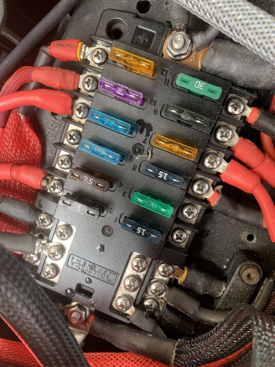

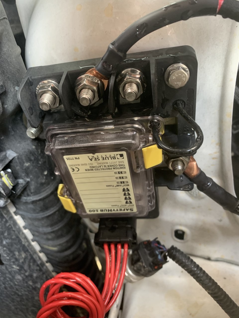

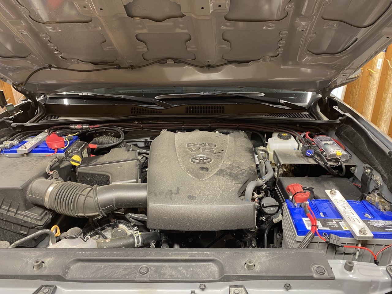

    0E8CDA1C-E65F-44D5-AE73-D2BB994B8D92.jpg 73A3012C-082C-4312-AE6A-998A8F4EB7CF.jpg 6BF278FA-315A-46AC-AC92-4545D62025D2.jpg 915AB0D2-B457-4CC0-AB05-3622DF37F520.jpg Redarc BCDC all the way! I use everything else blue sea systems from switch panels to fuse blocks and even MIDI fuses on the bcdc but this redarc is sealed and can take a beating plus everything mentioned above and great customer support and service along with nice guaranteed warranty

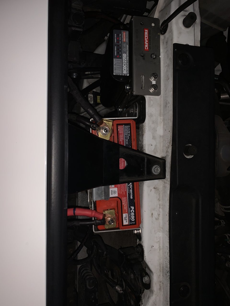

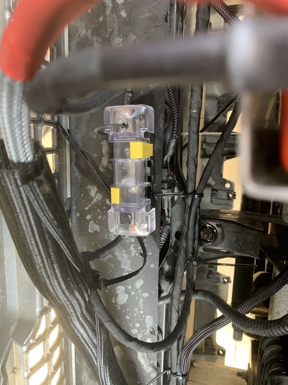

    WHERE DID YOU MOUNT THE AUX BATTERY?? and where is the BCDC mounted?

    Bilstein 8112/8100 ICON RXT Stage 2 JBA UCAs Archive Garage HH w Shackles Archive Garage U Bolt Flip kit Nitto Ridge Grapplers 255/80/R17 TRD Front Skid and RCI Transmission Skid Kenwood DMX 1057XR Head Unit Focal Utopia WM 3 way plus WM10 Sub Mosconi 5/30 and Genesis Dual Mono Amp
    In between the radiator and the grille and battery is mounted beside it

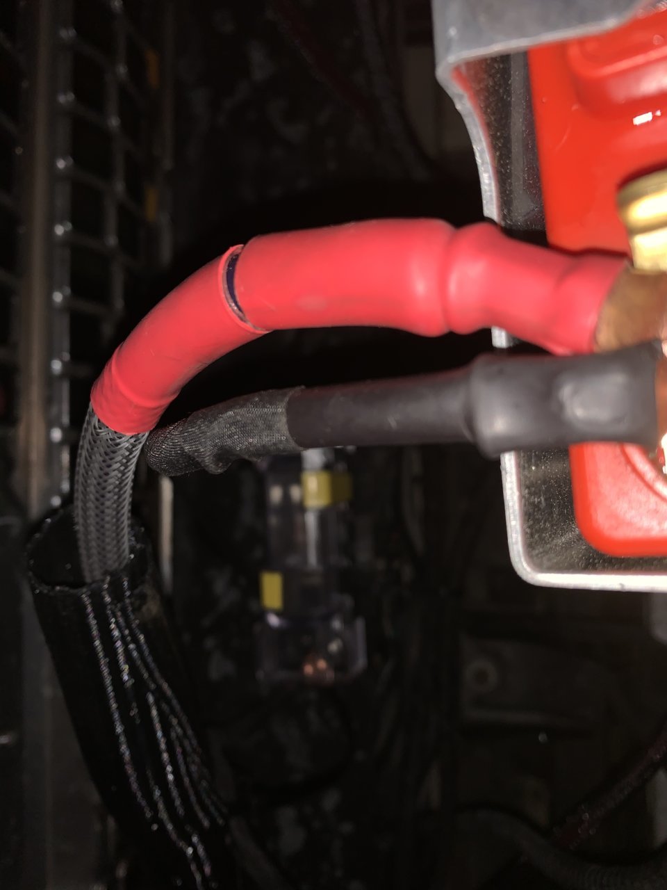

    5AD70BAC-9C5C-4AA1-9F98-497C3A84569D.jpg Blue sea systems midi fuse holder is behind the grille

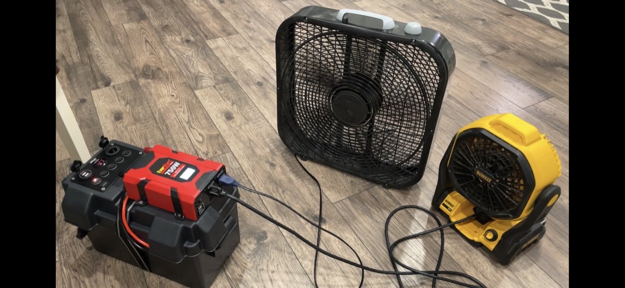

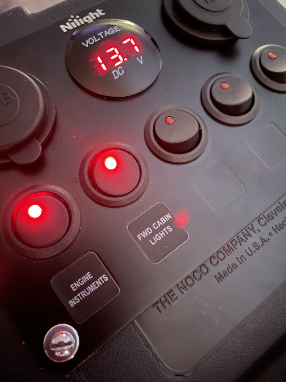

    I just made a DIY battery station with my original truck battery, a control panel, 750 watt inverter, and a Noco 2amp charger/maintainer which can charge off the bed inverter while driving or any wall outlet. You can easily set it up to charge on solar if you wanted to. It ran the box fan on high for 3 hours until the voltage started to get low and I called it quits.
    I highly recommend the Everstart Maxx batteries from Walmart made by Johnson Control, the warranty is unbeatable especially for $98 for a 24F.
