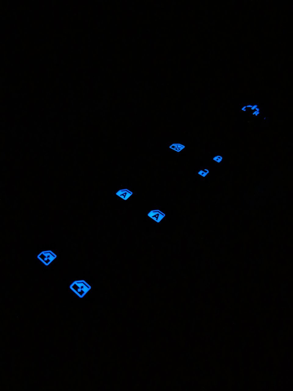

    Can anyone confirm if it has been established that the rear switches can be swapped out with one-touch switches to provide one-touch up/down all around? Not scared of some wiring either. Just on the driver's panel is all I care about, not on the doors themselves
    Pic of my driver side panel in my Pro. Sort of a bummer that it didn't come with one-touch all around from factory

    ^^ Not sure, but perhaps you could swap one switch around and let us know ^^ that would be a great find but I think there might be more to it than just the switch.

    I suspect as much. I remember looking into this about a year ago and scrapped the idea since no one had discovered anything, but now I'm more motivated to find out if this is a possible mod. I personally don't care for the alternative that's been discovered, imitating the 4runner's window function from the key fob. I don't have any need to operate my windows without being in the truck.
    If I figure anything out, I'll let you guys know.
