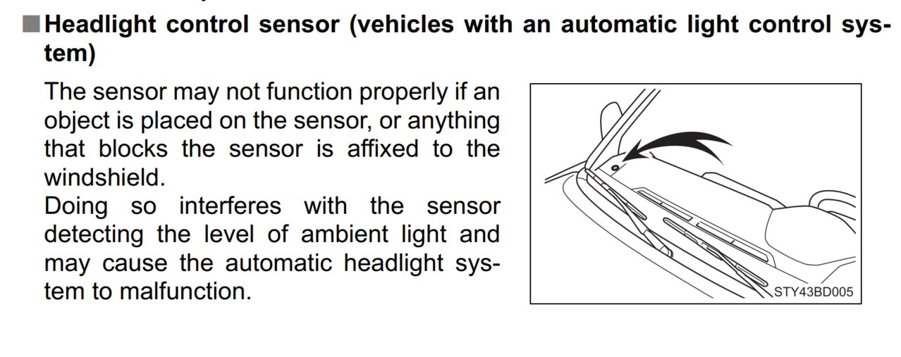

    There’s a forward facing sensor on the rear view mirror. Is that what you guys are saying is for the auto-dim mirror? I thought that sensor faced rearward.
    The sensor on the dash is definitely for auto headlights, but I’m not certain it’s for the auto brights. Wouldn’t that sensor face forward and be higher than the dash to detect on-coming traffic?
    I’m pretty sure auto high beams are part of Toyota safety sense so wouldn’t it be in the big clunky plastic piece high on the windshield?

    ^This. Either faulty sensor, wiring, or there's something blocking the sensor. In techstream you can adjust the sensitivity.

    The forward facing sensor on the rear-view mirror is for detecting ambient light-levels. The rear-facing sensor on the rear-view mirror is for detecting light coming from behind your truck by other drivers. BOTH are used to control the view of the rear-view mirror.
    The sensor which detects lights from on-coming traffic is the one on the dash at the passenger-side tweeter.

    That controls headlights auto on. See the link I posted above
    I can only find references to that sensor being used for auto on.
    Edit: as homiec posted, the manual refers to the dash sensor as a “headlight control sensor” while the subsequent pages refer to the automatic high beam sensor as a “camera sensor”.
    I maintain that the auto high beam sensor is part of TSS and the sensor is located in the cluster high on the windshield
