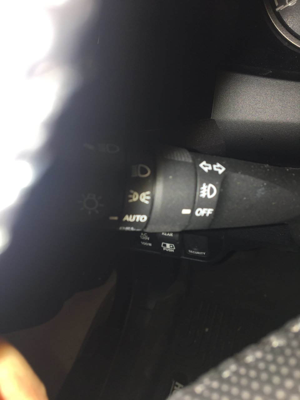

    2005 TRD Sport
    2005 TRD Sport Well-Known Member
    Jun 13, 2013
    #106239
    253
    NM
    17 Black LTD
    Chrome step tubes, bed extender
    E51F2694-1E45-4DE1-92E7-B9023790936A.jpg Unless you have the auto position, you have to turn the lights on manually. Sorry for the low quality pics

    IMG_1766 Light Switch .jpg Ok guys that is part of my point I must not have the "full" technology package because I do not have the "auto" on the switch and I cannot find that sensitivity adjustment on the touch screen.

    You don't have auto headlights. If you did there would be an 'Auto' position on the second click from the bottom...
