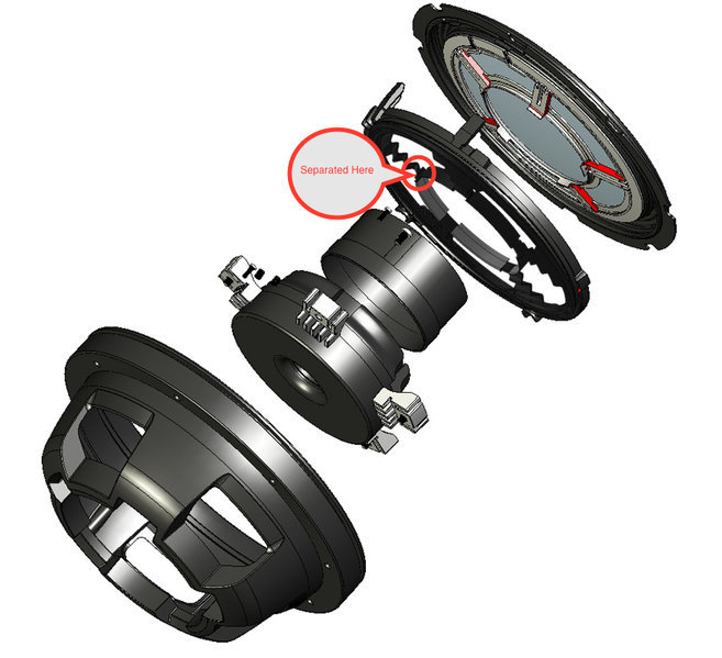

    Finally had some time to take the sub out and thoroughly inspect it. Found what appears to be separation at one of the 4 connections on the spider. Found this by using gently pressing down and hearing a metallic rattle/bump at this specific spot. Closer look with a flashlight unveiled the problem (very noticeable when compared to the remain 3 connections)
    See attached image for location...
    I cannot figure out how to disassemble the sub for better access, but was thinking I could just use some Loctite Epoxy to try resealing it?
    Thoughts/Recommendations?
  17. Mar 5, 2017 at 3:07 PM
    #17
    rob feature
    rob feature Tacos!
    Aug 10, 2011
    #61468
    1,795
    Colorado
    2003 4x4 V6 X-Cab SR5
    Shocks. Pegs. Lucky.
    Warranty? I know folks use E6000 on surrounds, but dunno about spiders.

  19. Mar 8, 2017 at 7:44 PM
    #19
    Knwilson
    Knwilson [OP] Well-Known Member
    Mar 1, 2013
    #98752
    67
    Loctite bandaid is working for now... Don't expect it to last, so I spoke with Marv to review options. I think I am going to move up to the 12TW3 with a new enclosure.
