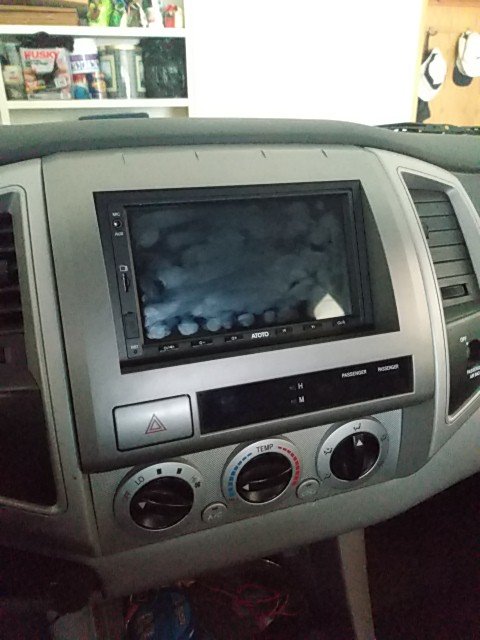

    CS693 are the 6 x 9's and the tweeters are the Subaru/Kickers bought from my local Subaru dealer. I had the same in my 3rd gen. Find the best price online for the Subarus and then most of the dealers will price match. There are youtube videos showing how to modify the tweeter connectors for the 2nd gens. Very easy to do. Worth every penny. Picture is of our 2012 but same done in our 2008.20210721_163112.jpg

    How did you get the area around the radio to fit the Atoto after moving it up from the lower position?
    I have an Atoto 8 mocked up at the moment and the screen is kind of low and not the best angle to see easily. I can see it, but up higher like what you've done would be better.
    The heater controls seem tight in your photo, can or have you done anything else since you posted the photo?

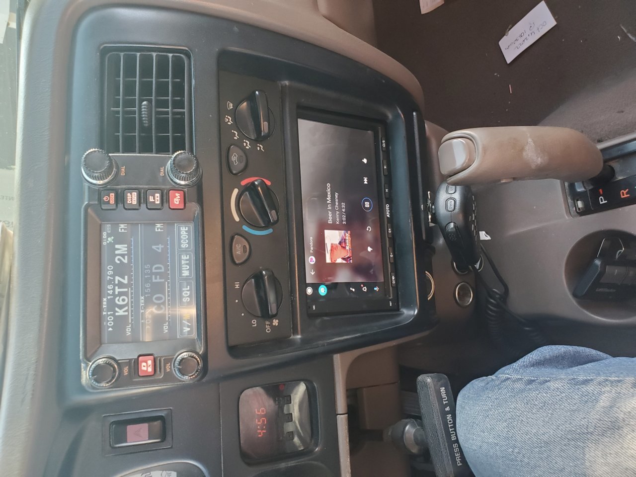

    Finely got mine all hooked up and trim reinstalled.
    Atoto 6, down below
    Back up camera installed at the 2nd license plate light. Removed the light on the right side and dremeled out to fit the camera little by little and glued in place.
    Ham radio on top is a Yeasu FTM-400

    I wondered the same thing. The RED wire for the camera needs power. I tied into it at the accessory RED in the adaptor harness and then taped into the back up light wire at the rear tail light. I didn't want to open the truck wires going to the back up light. So, on the back side of the tail light you will easily see the wire for the back up bulb. That's where the signal to the radio comes from to activate the screen to turn the camera on. Works pretty good once you figure out the line configurations shown on the screen.
