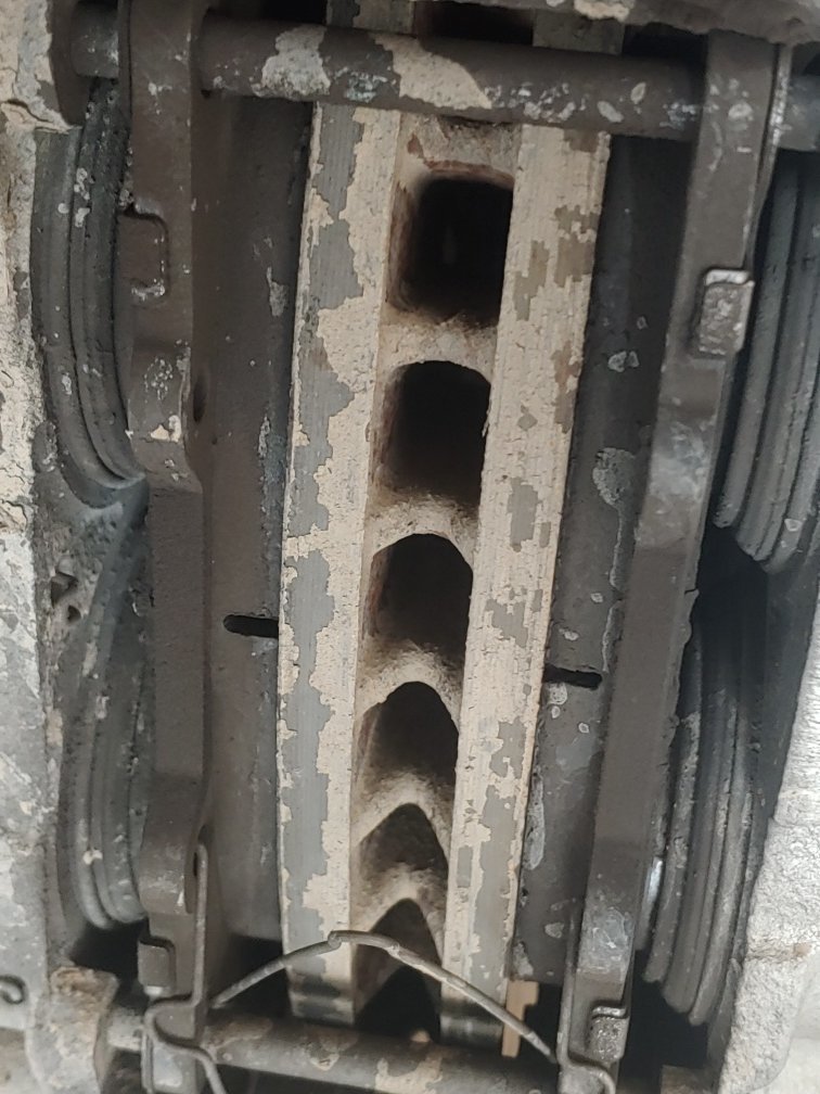

    These have just over 45k miles, and about 7mm remaining.
    Drivers
    Passenger

    when the wear is at the bottom of that slice/groove in the middle of the pad material

    Service manual limit is 1.0 mm (.039"). Your pads and caliper are covered in mud though. Are you cleaning and lubricating your calipers every 2 years per the maintenance booklet? If the pistons or retention pins seize up from mud, the pads can wear unevenly and you won't get full life out of the pads.

    Thanks. No I am not. The dealer did most of the maintenance but I did the last couple. I will clean and lube them at 50k.

    2-3mm are the failure/replace now.....3-4 means they have a little bit of life left... not much..

    Plenty left on those. Check them every 5k miles when you rotate the tires.

    For reference, 11mm is roughly new, so 7mm is like 60%
    They would benefit from a good blast with the washer.

    Start thinking about replacing pads at 4/32", replace at no thinner than 2/32"

    I'm at 91k miles on my original pads and my PA safety inspection in October told me I had 3 or so mm left. I'll replace them this week along with my rotors only out of convenience because I'm off work. Otherwise I'd let those bad boys ride.

    Still got a bunch of life left in those pads, as long as they're wearing even.
