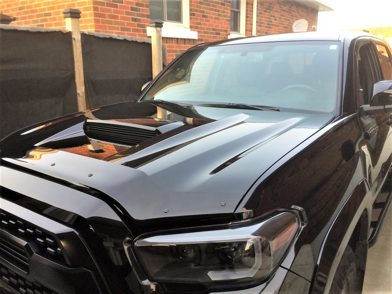

    Since the early 90's all vehicles have switched to water carrier paints because of the clean air act. Filtering the exhaust from the paint process would have been very costly.
    The new paints will never be as tough as the 2 part epoxy's, Urethane's and Lacquers of yesteryear.
    But they don't have things like lead, chromate and all these poisonous off gassing while they cure.
    Buy yourself a few packages of Microfiber towels, Only ever use touch free car washes....
    Best thing you can do for a new vehicle is what @Foozer said.
    Don't let the dealership touch it besides unload it from the truck and check fluid levels.
    No cloths from the dealership to touch the truck,
    tell them you would rather have a greasy palm print than a big swirl mark left on the truck.
    Then either take it to a detailing shop and have it ceramic coated (should be a LOT cheaper as they won't spend a day paint correcting it)
    Or watch a few youtube videos on how to use an orbital polisher,
    pick up a harbourfreight random DA polisher for $75 and some pads and compound.
    Then apply the Ceramic coating yourself about $100.
    Took me about 3hrs per coat to apply Cquartz UK 3.0 .
    (more time than that to do the paint polishing first though)
    Lol you Green guys ain't getting any sympathy from me!
    I have 202 Black, not even metallic, just black.
    As in if a fly farts on it you can see it from 10 paces.
    As in after you have finished detailing it, then reach for the camera...
    it's dirty again before you could take the lenscap off.
    When I got this truck from the dealership,
    It looked like porcupines had an orgy on it.
    Little bit of YouBewb watching and a lot of elbow grease later it looks 100 times better even after 4 years than the day it came off the dealer's lot.
    In fact there are a lot less swirl marks on it now as it approaches 4 years old that what I see in the dealer showrooms...
    Plus with Ceramic coating not only does it take a lot more to scratch/swirl it than the factory paint but it stays cleaner too. (not dirt or scratch proof though lol )
