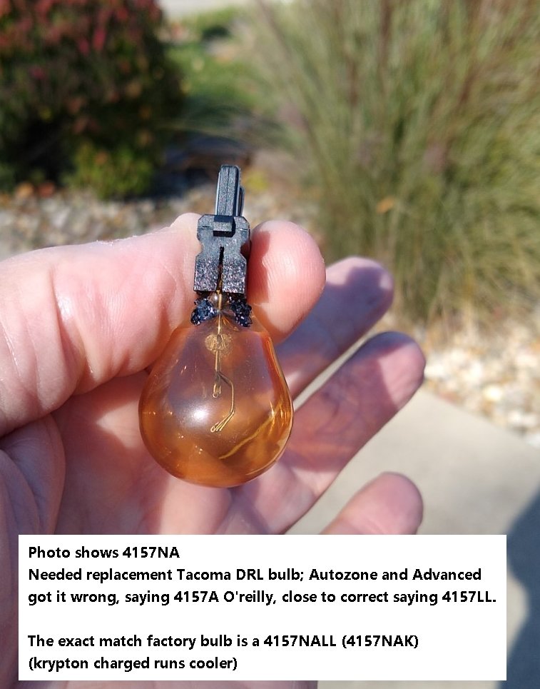

    Changed mine with Eiko 81136 4157NALL-4157NAK.
    As a rule, I always register in a forum of our vehicles or expensive equipment. I have found them a valuable resource when researching mods, repairs, issues and parts.
    From this latest issue (daytime running lights) I recommend looking parts up in your service manuals, calling a dealership parts department (don't buy there) or in forums. Don't trust auto parts stores! Also, always install "Long Life" krypton charged bulbs if available. I got my info from Tacoma World.
    Photo shows the result of installing the wrong amber bulb. "NA" after # means amber. Passenger side was the factory original 4157NAK. The glass bulb was loose in it's holder. Luckily the socket was still good, slightly browned but not melted.

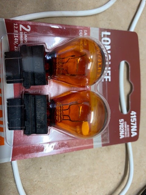

    Thank you guys for all the good info about the 4157NAK (Krypton) bulbs.
    I Changed all the bulbs in both headlight housings today on my 2012 SR5; noticed something interesting I thought I would share.
    For the turn signal bulbs that call for 4157 NAK, I found the pictured Sylvania bulbs at Autozone.
    The package is labeled 4157 NA, but the bulbs inside have 4157 NAK printed on them (see pic).2.5 gen turn signal .jpg
    So I assume these are Krypton, even though not labeled as such. They seem to be holding up for now, I'll update if they blow in a day or two.
    UPDATE: They both blew in about 2 hours. So much for Sylvania. Currently have some OEM bulbs on order from Toyota.
    If they don't work I might try the LEDs Mr. Pearson had success with. Thanks for the info!

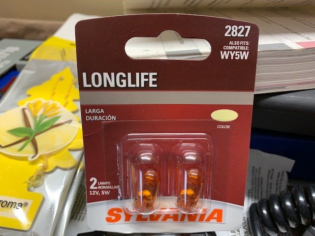

    Also I threw in a pic of the amber marker bulbs on the headlight corners, they are sylvania 2827 amber. The owner's manual doesnt give a number for these.2.5 gen marker bulb.jpg
